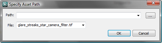

  • If a single asset is highlighted, you can change the path and the file name. The following dialog appears.
    To change the path, edit the Path field or use the ellipsis [...] button to browse for a new path. This changes the path only.
    To revert to a previous path, choose it from the drop-down list.
    To change the file name, edit the File field or choose a name from the drop-down history list. Note that this changes only the name of the asset file as pointed to in the scene; it doesn't change the actual asset file name. Use this to update the scene if the asset file name has changed.

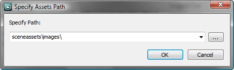

  • If multiple assets are highlighted, you can change the path but not file names. The following dialog appears.
    The dialog shows the portion of the current path that the highlighted assets and lets you specify a new one, either by editing the Specify Path field contents or by clicking the ellipsis [...] button and browsing to a different path.
    For example, if two assets are highlighted, and one asset's path is c:\max_files\maps1\ while the other's is c:\max_files\maps2\, the Specify Path field will show c:\max_files\. Changing this changes the complete path for all highlighted assets. Of course, they must all be present there for Asset Tracking to find them.
    To change only the portion of the path that all highlighted assets have in common, use Retarget Common Root (see the following).

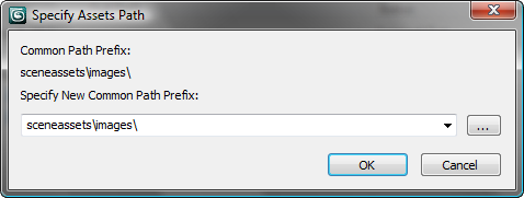

Lets you change only the part of the path that all highlighted assets have in common. This command opens a version of the Specify Assets path dialog that shows the common path prefix for the highlighted assets and lets you specify a new one, either by editing the Specify New Common Path Prefix field contents or by clicking the ellipsis [...] button and browsing to a different path. Use Retarget Common Root for repathing multiple files, particularly those in different directories within the common root.
For example, if all maps were originally in various subdirectories within c:\maps\ and the entire subdirectory structure was moved to d:\resources\maps\, you could repath all files simultaneously using Retarget Common Root.
If you change the common root for output files to a path that doesn't exist, you're prompted to confirm that you want to create the folder or folders. if you confirm, the output paths are changed in all appropriate locations, such as the Render Setup dialog.
