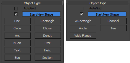

Start New Shape
A shape can contain a single spline or it can be a compound shape containing multiple splines. You control how many splines are in a shape using the Start New Shape button and checkbox on the Object Type rollout.
The checkbox next to the Start New Shape button determines when new shapes are created. When the option is on, 3ds Max creates a new shape object for every spline you create. When off, splines are added to the current shape until you click the Start New Shape button.
Shape Selection buttons
Lets you specify the type of shape to create.
