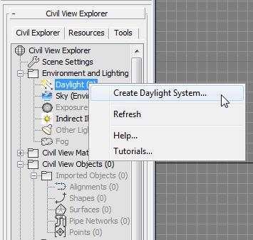

The easiest way to add a Daylight system to your Civil View scene is to right-click the Daylight node on the Civil View Explorer, and choose Create Daylight System.
After choosing this option, 3ds Max prompts you to create an mr Photographic exposure control. Click Yes to add the exposure control, then drag in the viewport to set up the compass and sun light for the Daylight system. See Sunlight and Daylight Systems.
When you first create a Daylight system, the default creation parameters are set to midday (noon) on the summer solstice (June 21). The default geographic location is San Francisco. 3ds Max automatically calculates the geographically correct angle and movement of the sun over the earth at a given location at a certain time and date.
