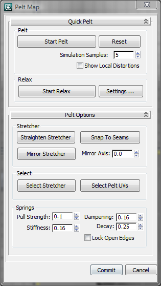

The primary Pelt Map commands are activated via the buttons on the Quick Pelt rollout. Other functions on this dialog let you adjust various stretching parameters.
These are the main controls for the simulation, in which the springs attached to the stretcher pull the pelt seam vertices out, flattening the UVs. For best results, alternate between running the simulation (click Start Pelt) and relaxing the mesh.
Runs the simulation, pulling the pelt seam vertices towards the stretcher points. The simulation runs continuously until you stop it by pressing Esc or clicking Stop Pelt (the same button). You can also stop it by clicking Reset, or Commit or Cancel at the bottom of the dialog.
Pelt affects only selected texture vertices. However, if no texture vertices are selected, it affects all of them.
Stops the simulation if it’s running, and returns the pelt and stretcher to their original condition.
You can also reset the pelt by exiting pelt mapping mode by clicking either Commit or Cancel, and then clicking the Pelt button again.
The number of samples around each pelt-seam point used in the simulation. A higher value results in a greater pulling effect. Default=5. Range=1 to 50.
When on, depicts the differences between texture vertices and mesh vertices for visible faces; that is, faces selected in the viewport when Display Only Selected Faces is on. For more information, see Show Edge Distortion.
Normally, when showing edge distortion, 3ds Max takes the entire mesh into account. This can result in an unrealistic depiction of distortion when you use pelt mapping on only part of a mesh (for example, the head of a character). For a more accurate depiction of distorted edges with respect to the part of the mesh that you're currently pelt-mapping, turn on this option, turn on Filter Selected Faces, and select in the viewport only the faces that you're currently pelt-mapping.
Normalizes the distances between mapping vertices. The relaxation process runs continuously until you stop it by pressing Esc or clicking Stop Relax (the same button).
Relax affects only selected texture vertices. However, if no texture vertices are selected, it affects all of them.
Opens the Relax Tool dialog for setting relax parameters. While this dialog is open, you can start the relax by clicking its buttons or the Start Relax button on the Pelt Map dialog.
These tools help adjust the stretcher shape.
Lets you specify a polygonal outline for the stretcher by moving points. When this mode is active, move one stretcher vertex, and then move a second, non-adjacent point to line up all intervening vertices in a straight line between the two. This process is fully interactive; as you move the second vertex, the intervening vertices continually change position to maintain the straight line. Continue moving vertices to create a polygonal outline; to quit, click Straighten Stretcher again.
Aligns all the stretcher points to the edge seams on the pelt UVs. This causes the stretcher to take on the pelt outline.
Mirrors the stretcher points from one side of the mirror axis (see following) to the other. By default, Mirror Stretcher mirrors the points from the right side to the left.
Lets you specify the orientation of the mirror axis. The axis takes the form of three yellow lines forming a T. The leg of the T indicates the side that will be mirrored when you use Mirror Stretcher (see preceding), and the crossbar indicates the axis across which the mirroring will occur. Default=0.0. Range=0.0 to 360.0.
These controls let you select all the stretcher points or the pelt UVs. As with other selection methods, you can press and hold Ctrl when you use either of these to add to the current selection. That is, to select all stretcher points and pelt UVs, click one button, press and hold Ctrl, and then click the other button.
Selects all stretcher points.
Selects all pelt texture vertices.
These parameters control the springs that are used to stretch the pelt. In most cases you won’t need to change these values, except possibly for Pull Strength.
The magnitude of the stretching action when you click Simulate Pelt Pulling. Default=0.1. Range=0.0 to 0.5.
If the stretching is too gradual, increase Pull Strength for a more forceful stretching action.
Applies a dampening or inhibiting factor to the pulling action. The higher the Dampening value, the greater the inhibition of the stretcher. Default=0.16. Range=0.0 to 0.5.
Sets the rate at which the springs pull. The higher the Stiffness value, the more abrupt the pulling action. Default=0.16. Range=0.0 to 0.5.
The rate of falloff of the influence of each pelt-seam vertex on the other mapping vertices. Higher Decay values typically result in significantly greater stretching, or undesirable results. For best results, keep the Decay value low. Default=0.25. Range=0.0 to 0.5.
Locks the open edges in place. This typically applies to using the stretcher on a partial selection of mapping vertices in the pelt region. When Lock Open Edges is on, selected vertices next to unselected vertices tend to stay in place during stretching. When Lock Open Edges is off, the selected vertices tend to pull away from the unselected vertices.
