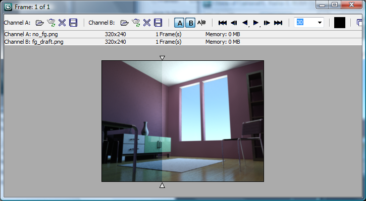

The RAM Player loads images and image sequences into RAM and displays them at different frame rates. The utility has two channels: A and B. You can load two different images or sequences into the channels to display or play back together, making it easy to compare them.
To set the position of the divider between the two channels, shown as triangles at opposite edges of the image, drag in the channel display window. To scrub the animation, drag with the right mouse button held down: rightward to advance and leftward to rewind.

Displays an Open File dialog that lets you choose a file to load into the channel. After you have selected a file, the RAM Player Configuration dialog opens; it allows you to set height, width, and memory usage for that channel.
Loads the last rendered image into the channel. Nothing is displayed if there is no last rendered image available.
Unloads the image in the channel and frees up your memory.
Opens a Save File dialog that lets you save the animation or image from the respective channel. You can save the animation as an AVI file or a sequence of numbered images.
When on, shows the file loaded into channel A. When both channels are enabled, split screen markers appear as two triangles. These markers indicate where channel A ends and channel B begins. You can move the divider with the left mouse button.
When on, shows the file loaded into channel B. When both channels are enabled, split screen markers appear as two triangles. These markers indicate where channel A ends and channel B begins. You can move the divider with the left mouse button.
Toggles between the view of the two channels side-by-side or one on top of the other.
Returns the RAM Player to the first frame of the animation.
Goes to the previous frame in the animation. If the RAM Player is at the first frame, Previous Frame goes to the last frame.
Plays the frames in the animation in reverse order. The flyout contains an option to play the animation once in reverse and then stop.
Plays the frames in the animation in rendered order. The flyout contains an option to play the animation once and then stop.
Advances to the next frame in the animation. If the RAM Player is at the last frame, Previous Frame goes to the first frame.
Goes to the last frame of the animation.
Sets the desired frame rate in frames per second. When playing back a movie, you see the frame rate displayed in the title bar of the RAM Player. You can select a predefined frame rate or type in your own frame rate value.
Ctrl+right-clicking the mouse in the display window displays the color of the pixel in the color selector swatch. Stop the animation to get a consistent pixel reading. The RGB values of the pixel display in the title bar of the RAM player.
When on, ensures that the two frames in channels A and B are synchronized. Enabling this feature can slow down the playback frame rate.
