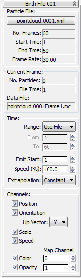

The operator parameters appear on a rollout on the right side of the Particle View dialog.

The user interface appears in the parameters panel, on the right side of the Particle View dialog.
Contains a button that shows the name of the XML point-cloud file that defines the particle-birth parameters; to choose a different file, click the button and use the file dialog that opens. This group also contains read-only, basic data about the particle file, including the total number of frames, start and end times, and the animation frame rate.
Read-only particle data for this frame only (change the frame with the time slider). Shows the total number of particles, the frame number of the active MC file for this frame, and the name of the MC file.
The current frame data are of interest if the Speed (%) value (see following) is not 100.0. In such a situation the current frame in 3ds Max might not be the same as the active MC frame, so this group tells you which frame of the nCache file Particle Flow uses to populate the current frame. For example, if the current frame is 30 and the Speed (%) value is 80.0, the File Time value is 24.
Use these toggles to specify which data channels to use from the MC file sequence. The point-cloud (XML) file specifies the channels for which data is available; channels without specified data are unavailable in this group.
This setting can compensate for the fact that various programs use different axes for the vertical direction. Maya lets you choose between Y-up and Z-up, Softimage uses Y-up only, while 3ds Max uses Z-up. Because the incoming particle file does not specify the up vector, you need to choose it. The default is Y-up because it will be the right convention most of the time.
You can observe the effect of this setting if you use the Shape Instance operator in your event with Orientation (see preceding) on in the Birth File operator. If you use a cone, for example, you will see that the final orientation of the particles depends on the Up Vector setting.
Use the numeric setting to specify the map channel to which the incoming color information should be applied. This value must be used in the material associated with a Material Static operator.
Use the numeric setting to specify the map channel to which the incoming opacity information should be applied. This value must be used in the material associated with a Material Static operator.
