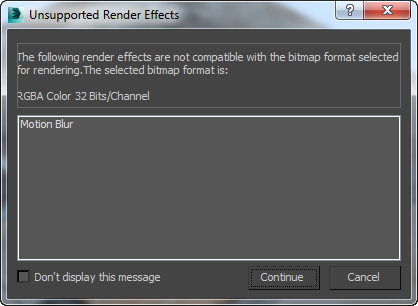

Rendered Image Effects and 32-Bit Floating-Point Output
Most rendered image effects in 3ds Max are not compatible with 32-bit floating-point output, such as that provided optionally by the mental ray renderer. If you render using one or more unsupported effects, the following dialog appears:
You can choose to continue rendering without the unsupported effects, or cancel the render.
