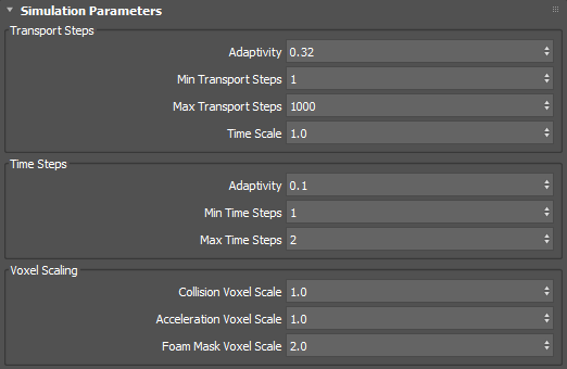

Simulation Parameters rollout
Transport Steps group
Adaptivity
Controls the number of iterations used to advect the particles along the voxel velocity field, after the pressure calculations have been performed. Lower values will be less likely to trigger further substeps.
Be careful not to increase this setting too much at once, particularly for values close to 1.0. Doing so may cause unnecessarily long computations. Also note that distances are measured in voxel lengths, which means a lower master voxel size may trigger extra iterations for particles at a given velocity.
Min Transport Steps
Sets the minimum number of transport iterations.
Max Transport Steps
Sets the maximum number of transport iterations.
Timescale
Changes the speed of the particle flow. Values greater than 1.0 speed up the flow without introducing any new velocities or accelerations, while values between 0.0 and 1.0 slow it down.
Time Steps group
Adaptivity
Controls the number of iterations of the whole simulation per frame, including the voxelization, pressure, and transport phases. Lower values will be less likely to trigger further substeps.
Caution: Be careful not to increase this setting too much at once, particularly for values close to 1.0. Doing so may cause unnecessarily long computations. Also note that distances are measured in voxel lengths, which means a lower master voxel size may trigger extra iterations for particles at a given velocity.
Min Time Steps
Sets the minimum number of time step iterations.
Max Time Steps
Sets the maximum number of time step iterations.
Voxel Scaling group
Collision Voxel Scale
A multiplier for the Master Voxel Size used for voxelizing all collision objects.
Acceleration Voxel Scale
A multiplier for the Master Voxel Size used for voxelizing all accelerator objects.
Foam Mask Voxel Scale
A multiplier for the Master Voxel Size used for voxelizing all foam masks.
