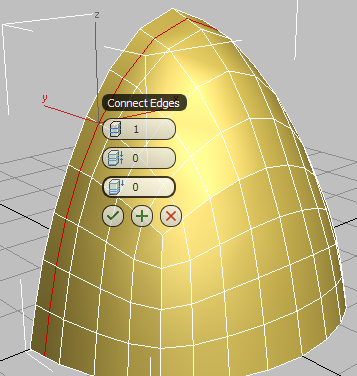

- In the viewport,
select a polygon edge as shown in the next illustration, then on the Modify Selection panel, click
3ds Max selects all edges parallel to the first one, in a ring around the object.
- On the Loops panel,
Shift+click
(Connect).
3ds Max draws a single loop of edges around the selected edges. It also displays the “caddy” controls for the Connect tool.

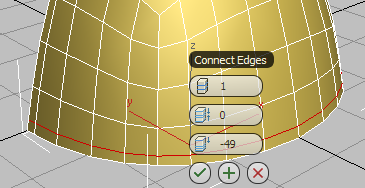

By default, the loop is placed in the center of the selected edges, but the negative Slide value you will specify in the next step will position it to the left of center.
- On the third control of the caddy, Slide, drag until the value equals
–50, and then click
(OK).
Edge slides to the left

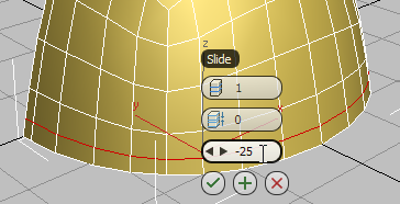

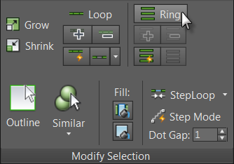

- In the viewport,
click to select a vertical edge on any polygon at the bottom row of the helmet, then on the ribbon
The Ring tool automatically selects all the vertical edges.
Shift+click
(Connect).
Once again,
3ds Max displays the caddy controls for the Connect tool.
- Change the value of the Slide control to
–25, then click
(OK).

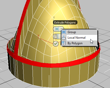

Extrude the helmet seam and rim:
- On the Polygons panel,
Shift+click
(Extrude).
3ds Max displays the caddy controls for the Extrude tool.
- On the first control, Group, choose Local Normal from the drop-down list.
- On the second control, Height, change the value to
1.0
, then click
(OK).
