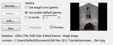

View the bitmap for the second house, and note its dimensions:
- On the main menu, choose Rendering
View Image File. In the View File dialog, navigate to the
\sceneassets\images
folder, and highlight
fac4.jpg.
In the lower-left corner of the View File dialog, a status line shows the dimensions of the image, which are 1200 x 1740 pixels.
- Click Open to view the image at full size.
Close the image window after you have looked at the photo.

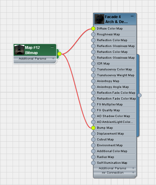

Open the Slate Material Editor.
- In the Material/Map Browser panel, locate Materials
mental ray, and drag the Arch & Design entry to the active View.
- Double-click the Arch & Design material node to display its parameters.
- Name the material Facade 4.
- On the Templates rollout, choose Matte Finish from the drop-down list of templates.
- On the Material/Map Browser panel, locate Maps
Standard, and drag the Bitmap entry to the active View.

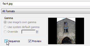

- In the file dialog that opens, choose fac4.jpg as the bitmap, turn off Sequence, and then click Open.
Important: In the Select Bitmap Image File dialog, be sure to turn off the Sequence toggle.
When Sequence is on, 3ds Max attempts to create an IFL animation, and we want to open only the single image.
- Wire the Bitmap to the Arch & Design material’s Diffuse Color Map and Bump Map components.

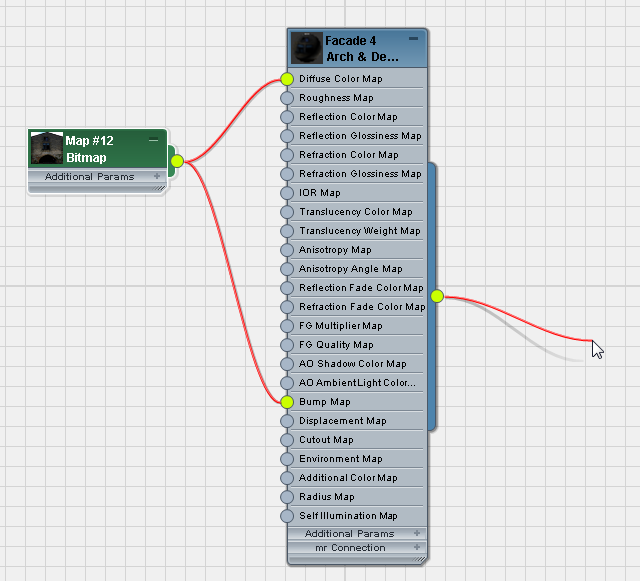

- Click the Facade 4 material node to make it active, then turn on
(Show Shaded Material In Viewport).
- Drag from the Arch & Design material node’s output socket (the small circle on the right), and drop the material on the Facade 4 plane in a viewport.
Dragging and dropping is another way to apply a material.
Note: You won’t see the wire as it crosses the panel at the right of the Slate Material Editor, or in the viewport.

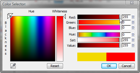

- Click the second of the color swatches that follow Show Cage.
This color is the color of highlighted polygons.
- On the Color Selector, choose a bright red as the highlight color, and then click OK.
