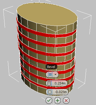

- On the Edit Polygons rollout, click the
Settings button to the right of the Bevel button.
3ds Max displays the caddy controls for the Bevel tool.

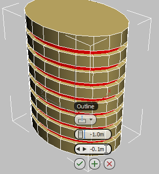

- On the Bevel caddy, in the first control, choose Local Normal from the drop-down list. In the second control, Height, enter
–1.0, and in the third control, Outline, enter
–0.1 to give the edges of the bevel a very slight slope. Click
(OK).
