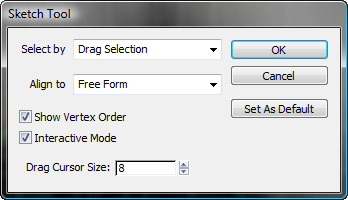

- On the Edit UVWs dialog menu bar, choose Tools
Sketch Vertices. 3ds Max opens a Sketch Tool dialog.
The Sketch Tool options you want to use are Align To = Free Form, and Interactive Mode turned on.
- Make sure the Sketch Tool settings are correct, and then click OK.

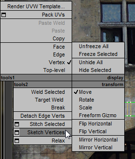

- Right-click the Edit UVWs window, and choose Sketch Vertices from the quad menu.
When you use the Sketch Tool with Free Form drawing, you work in a two-step manner: First, drag to select the vertices you want to reposition; Second, draw a freehand stroke to show Edit UVWs where to place the selected vertices.
