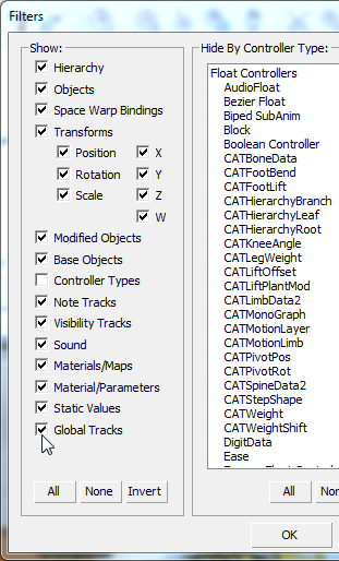

    Tip: If the Sound track isn't visible after you switch to Dope Sheet mode, click Keys: Dope Sheet toolbar (Filters), and then in the Filters dialog Show group, click to turn on Global Tracks.
