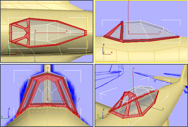

  2. If the metal parts of the canopy are not already selected, the on the main toolbar open the Name Selection Sets drop-down list, and choose canopy metal.
  3. On the ribbon Properties panel drop-down portion, click (SmGroups).
    3ds Max opens the Smoothing Groups dialog.
  4. In the Smoothing Groups dialog, assign the metal polygons a value of 32.

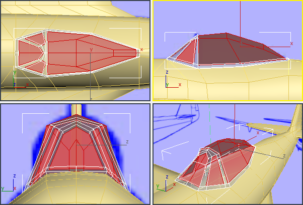

  5. Press Ctrl+I to invert the selection again, and then assign the glass faces a smoothing-group value of 24.

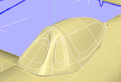

  3. On the ribbon Edit panel, turn on (NURMS). On the ribbon Use NURMS panel, increase the value of Iterations to 2.

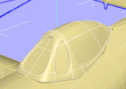

    This is far too much smoothing. As with the fuselage, you now need to take smoothing groups into account.

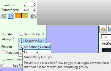

  4. On the ribbon Use NURMS panel drop-down portion Separate By drop-down list, turn on Smoothing Groups.

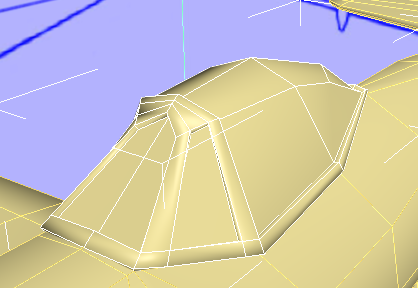

    Now the metal and glass portions of the canopy appear more distinct.
    With smoothing groups taken into account, there are well-defined edges between the glass and the metal parts of the canopy. On the other hand, the shape of the windshields is far too rounded. You will fix that in the next procedure.
