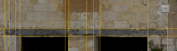

Correct the outline of the lintel beam:
- Click the Front face of the ViewCube to return to a Front view.
Pan and
Zoom to get a good view of the faces that show the lintel beam.
As you can see in the bitmap, the lintel has an irregular outline. You will edit the faces so they correspond to the outline of the wooden beam.
- On the ribbon, click
(Vertex) to go to the Vertex sub-object level.
- At the left end of the lintel,
move the three lower vertices along the Y axis so they follow the outline of the beam.

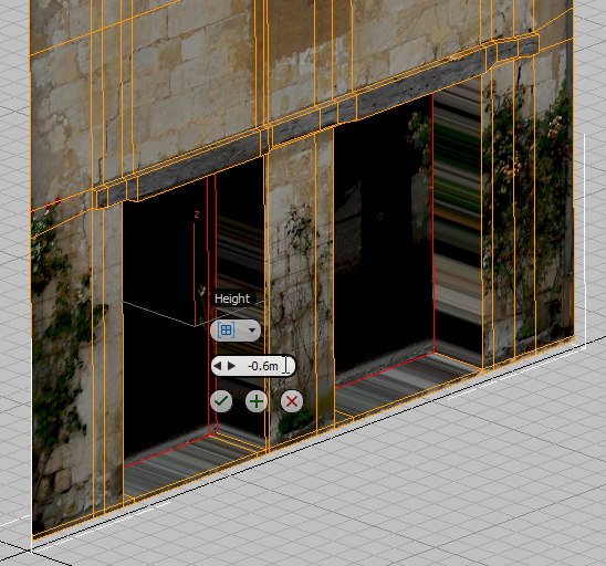

Add depth to the doors:
Zoom,
pan, and
orbit (or use the ViewCube) to get a better view of the doorways.
Click and Ctrl+click to select the doorway faces. Include the portion with stone to the left of each door. (The left-hand doorway has an extra sliver of face that the right-hand doorway does not have.)
- On the ribbon, Shift+click
(Extrude), then use the caddy’s Height field to extrude the doorways inward by a value of –0.6m.
- Click
(OK) to accept the extrusion.
Orbit (or use the ViewCube) to see the doorways from the other side.
(Edge) to activate the Edge sub-object level.
Click and Ctrl+click to select the four vertical edges that are part of the doorways, but whose faces show stonework.
Move these edges to the right along the X-axis until the faces show only the shadows beyond the door.
Incidentally, the perspective captured by the camera helps with the texture projection onto the left-hand doorjambs: These now look good. The right-hand doorjambs don’t look as good. This is a problem that you will fix in a later lesson.
- Click
(Edge) to exit the Edge sub-object level.
