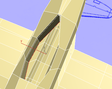

The P-47 fuselage now has a cockpit-shaped hole in it. To make the model a continuous surface again, you will add faces to form the interior of the hole.

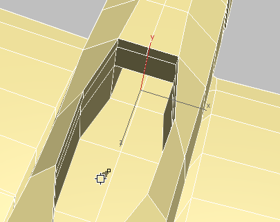

- On the ribbon
Polygon Modeling panel, activate
(Border).

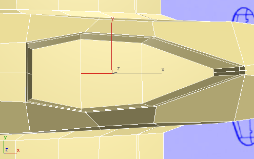

Click the edge of the cockpit to select all of the border edges.

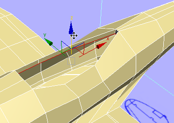

- Shift+move the border downward to clone it and create a rim for the cockpit.
- Press Alt+X to turn on X-Ray display again.

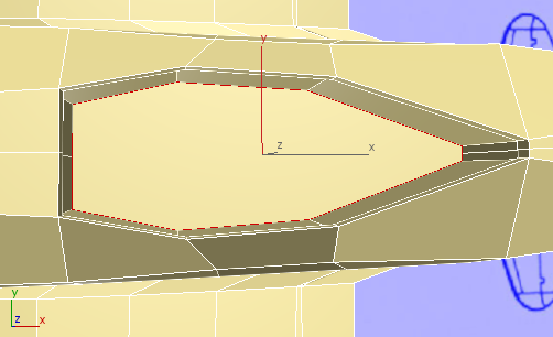

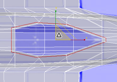

- In the Top viewport, Shift+scale the new border uniformly, to make a cockpit interior that is wider than its rim.
Watch all four viewports when you do this step: You don’t want the sides of the cockpit interior to extend beyond the outside of the fuselage!

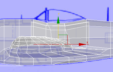

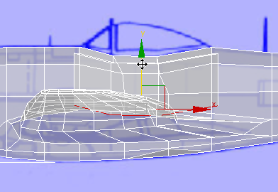

- In the Front viewport, Shift+move the cockpit border down, until the new border is just above the level of the wings.
- On the ribbon
Align panel, click
(Align Y) to make the new border horizontal.

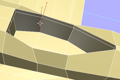

Add a floor to the cockpit:

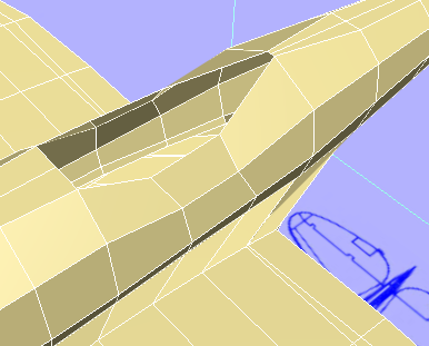

- Press Alt+X to turn off X-Ray display.
- In the Perspective viewport,
zoom,
pan, and

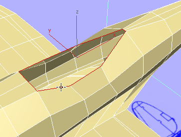

orbit so you can see most of the opening at the bottom of the cockpit.
The bottom of the cockpit is still an open hole.
- On the ribbon
Geometry (All) panel, click
(Cap Poly). 3ds Max creates a polygon to cap the open border.

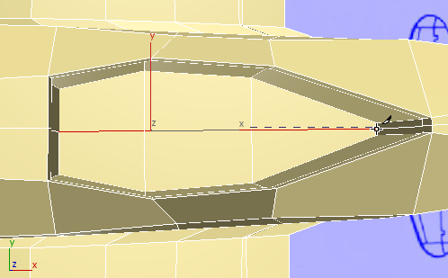

The polygon you just created is large and multisided, so you need to subdivide it into quadrangular polygons.
- On the ribbon
(Vertex).

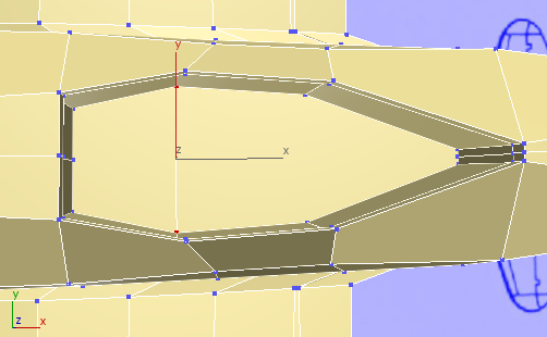

- Two lateral edge loops were interrupted by the cockpit hole, and now they are interrupted by the large polygon that forms the cockpit floor. To fix this,
click and Ctrl+click to select the two vertices where the forward edge loop stops at the cockpit floor, then on the ribbon
Loops rollout, click
(Connect).
- Do the same for the trailing pair of edge loop vertices.

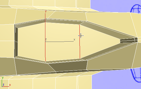

- On the ribbon
(Edge).
Click an empty part of the viewport to deselect any edges that are automatically selected, then click and Ctrl+click to select the two edges you just created.
Note: Even if the two edges are selected by default when you switch to the Edge sub-object level, deselect them and then select them explicitly: Otherwise, the default edges created in the next step, when you click Connect, will form too complex a web of edges.
- On the ribbon
Loops panel, click
(Connect).

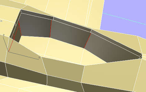

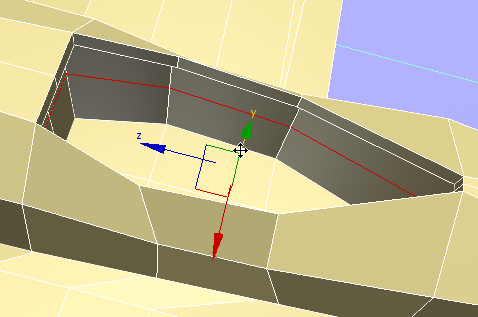

Click to select one of the vertical edges along the side of the cockpit interior.
- On the ribbon
Modify Selection panel, click
(Ring). 3ds Max selects all the vertical edges, in a ring around the inside of the cockpit.

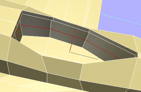

- On the ribbon
Loops panel, click
(Connect). 3ds Max connects the edges with a new horizontal loop of edges.
- On the ribbon
Edit panel, activate
(Constrain To Edge).
Move the new edge loop up a bit. Tip: Change the coordinate system to Local before you move the edge loop.

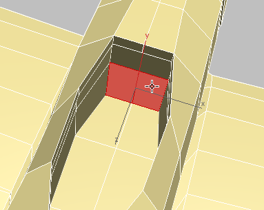

- Go to the
(Polygon) sub-object level.

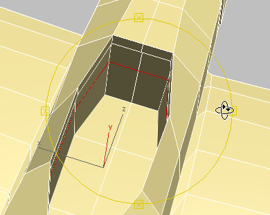

Click and Ctrl+click to select the two polygons at the bottom of the front wall of the cockpit interior.
- On the ribbon
Polygons panel, turn on
(Extrude). Drag to extrude the polygons forward, providing leg room for a pilot. (The two polygons above the leg room but below the cockpit rim would be the location of the instrument panel.)
