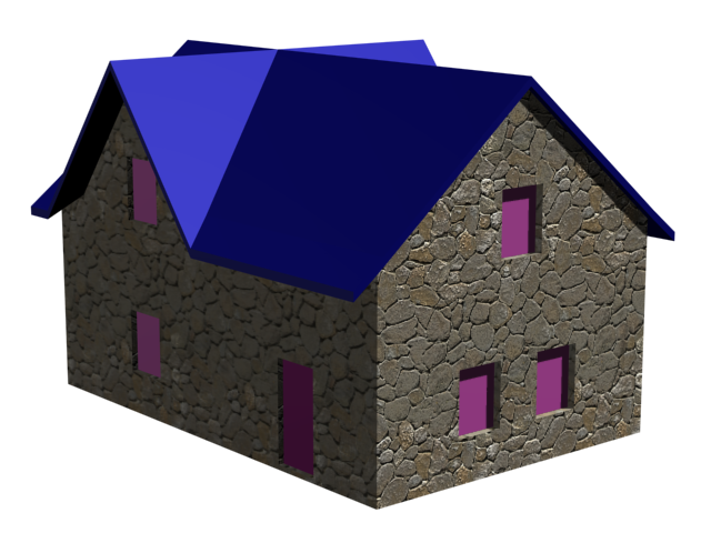

Texture the walls of the house:
    The walls of the house present familiar techniques.
  1. On the main toolbar, open the Named Selection Sets drop-down list, and choose the house selection set.
    3ds Max selects the farm house.
  2. Right-click and choose Isolate Selection from the quad menu.
  3. Click an empty area of the viewport to clear the selection, and then click the House object to select the walls.
  4. In the Slate Material Editor, drag a new Standard material node to the active View, double-click it, and name the new material Masonry.
  5. Drag a new Bitmap node to the active View, choose masonry.fieldstone.jpg as the texture, and wire it to both the Diffuse Color and Bump components of the Masonry material node.
    Texture for the house walls
  6. Double-click the Masonry material node to see its parameters. On the Maps rollout, change the Bump amount to 90.
  7. Click (Assign Material To Selection), and then turn on (Show Shaded Material In Viewport).
  8. Apply a UVW Map modifier to the house walls. Change the map projection to Box, and set Length = Width = Height = 5.0m.
    House walls with a masonry texture

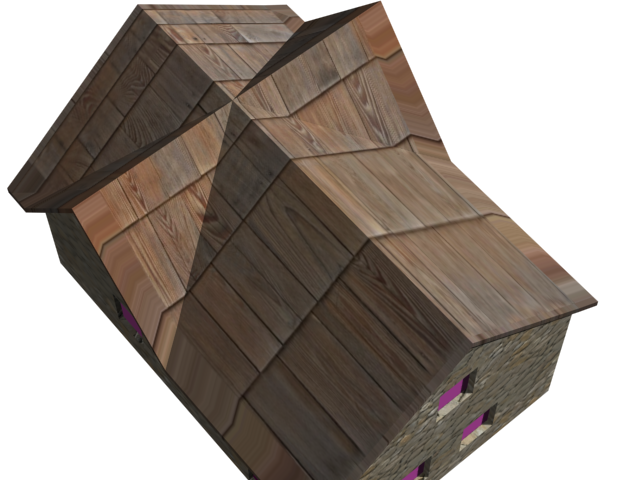

    The roof, on the other hand, presents a problem. With its two gables, there is no straightforward way to map the pattern using UVW Map.
    Shingle texture for roof of house
    With default mapping (you don’t need to go through these steps, yourself), the texture doesn’t look right. Even if you were to adjust the scale or change the projection type, the shingles wouldn’t conform to the direction of the gables.
    Default texture mapping for the roof

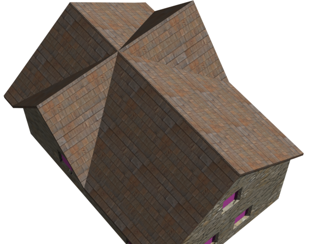

    The solution is to use a different modifier, Mapscaler, to handle the texture mapping.
  1. Select the House-Roof object.
  2. In the Slate Material Editor, drag a new Standard material node to the active View, double-click it, and name the new material HouseRoof.
  3. Drag a new Bitmap node to the active View, choose shakes.weathered.jpg as the texture, then wire the new Bitmap to the HouseRoof material node’s Diffuse Color component.
  4. Click the HouseRoof material node to make it active.
  5. Click (Assign Material To Selection), and then turn on (Show Shaded Material In Viewport).
  6. Go to the Modify panel. From the Modifier List, choose MapScaler.
    Note: Be sure to choose “MapScaler” from the list, and not “MapScaler (WSM)”. The world-space (WSM) version of MapScaler has a similar effect, but is not quite the same.
    The MapScaler modifier maintains the map scale relative to the object (in this case, the roof), and by default it wraps the texture so the shingles follow the angles of the roof.
    Shingle texture mapped using MapScaler
