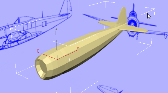

Check the Airplane Geometry
In this lesson, you make one adjustment to correct an artifact that occurred when you created the horizontal stabilizers, and then you use NURMS smoothing to check the overall model.

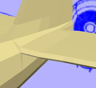

  4. In the Perspective viewport, zoom in (and otherwise adjust the view as necessary) to get a good view of the area where the left-side stabilizer joins the fuselage. Press F4 to turn off Edged Faces display.

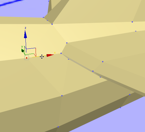

    The horizontal stabilizers look good, but where they join the fuselage, there are two faces that are awkwardly narrow. You can fix this by moving a single vertex.

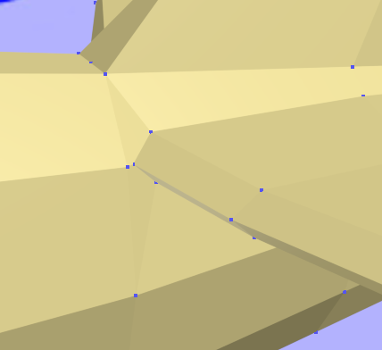

  5. Go to the (Vertex) sub-object level.
  6. In the Perspective viewport, zoom in still further to get a good view of the vertices that surround the narrow faces.
  7. On the ribbon Edit panel, activate (Constrain To Edge).
  8. Activate (Select And Move), then select the forward vertex where the narrow faces join.
  9. Move the vertex forward along the edge so the fuselage faces have more area.
    The wider faces will smooth more easily.

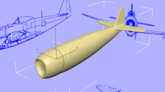

  2. On the ribbon Edit panel, click (Use NURMS).
    The NURMS option (it stands for Non-Uniform Rational Mesh Smooth, an industry-standard method) is provided for smoothing editable polygon surfaces.
  3. On the ribbon Use NURMS panel, increase the number of iterations to 2.
    The airplane model, with its stabilizers, is looking good. Some faces, especially those at the air intake, are being smoothed more than they ought to be: You will fix this in a later lesson.
