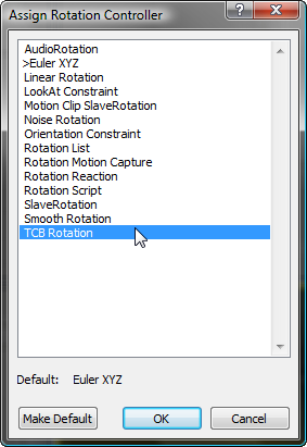

  3. In the Assign Controller window, click to highlight the Rotation: Euler XYZ item.
  4. Click (Assign Controller).
  5. On the Assign Controller dialog, click TCB Rotation, then click OK.
    The rotation controller listed in the Assign Controller rollout changes to TCB Rotation.

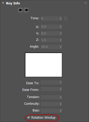

  6. Scroll down to the bottom of the Key Info rollout and turn on Rotation Windup. This will allow you to set rotation keys greater than 180 degrees.
    Important: You must turn on Rotation Windup, or the animation won't work correctly.

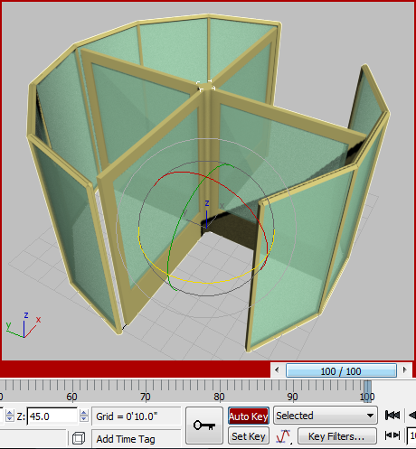

Animate the hub:
  1. Turn on .
  2. Drag the time slider to frame 100.
  3. Click to activate (Select And Rotate).
  4. Rotate the hub 360 degrees about the Z axis. Watch the coordinate display to get the correct rotation.
    Tip: To make setting rotations easier, turn on Angle Snap by pressing the A key.
    The Time Slider now displays keyframes as small rectangles at the beginning and at the end of the time segment.
    Rotation key at frame 100

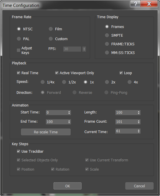

  1. Click (Time Configuration).
    3ds Max opens the Time Configuration dialog.

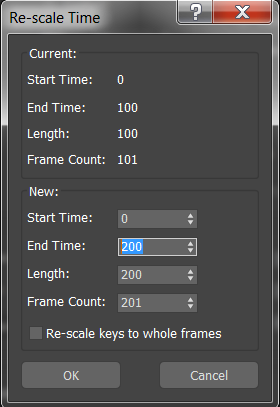

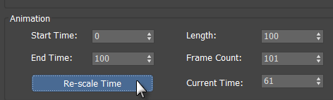

  2. In the Animation group, click Re-scale Time.
  3. On the Re-scale Time dialog, change End Time to 200, then click OK.
  4. Click OK to close the Time Configuration dialog.
    The Time Slider now displays 200 frames, with a key at frame 0 and frame 200.
