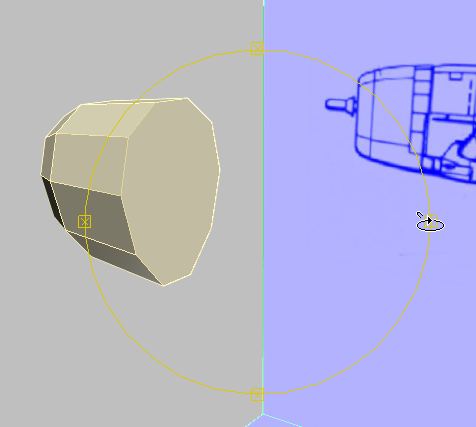

  2. Orbit the Perspective viewport so you can see the back of the cowl.
  3. Click to select the polygon at the rear of the cowl.
  4. On the ribbon Polygons panel, click (Inset). In the Perspective viewport, drag the mouse down to inset the rear of the cowl.
  5. On the ribbon Polygons panel, click (Bevel). In the Perspective viewport, drag downward to create a shallow recess at the rear of the cowl.

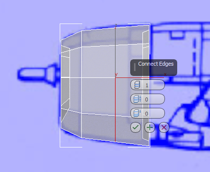

  3. Click to select one of the longer edges along the length of the cowl.
  4. On the ribbon Modify Selection panel, click (Ring).
    The Ring tool selects a ring of comparable edges, about the circumference of the cowl.
  5. On the ribbon Loops panel, Shift+click (Connect).
    Shift+clicking Connect displays the caddy controls for the Connect tool. These let you adjust the edge connection interactively.

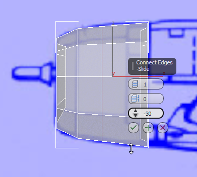

  6. On the caddy, drag the value of the lower spinner, Slide, to slide the new vertical edge to the left, so it is beneath the bulge in the cowl.
  7. When the edge is in the right place, click (OK).

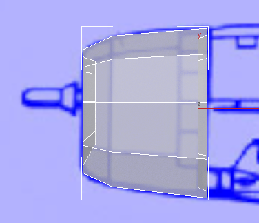

  8. Scale the new edge up along the Y axis so the cowl has a bulge that better matches the blueprint image.
  9. Click (Edge) again to exit the Edge sub-object level.
Now the P-47 engine cowl is essentially complete, as far as polygon shapes go. (You will add some detail later, to improve the way 3ds Max smooths this part of the model.)
