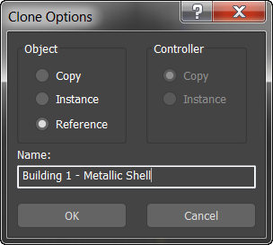

  3. From the menu bar, choose Edit Clone. In the Clone Options dialog Object group, choose Reference and change the name of the object to Building 1 - Metallic Shell. Click OK.

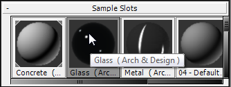

  4. In the Sample Slots section of the Material Editor Browser (on the left), locate the Glass material, then drag it to the View1 window .
    (The View, initially labeled View1, is the large window in the center of the Slate Material Editor where materials and maps appear as nodes that you can wire together in various ways.)
    3ds Max asks whether to make this a copy or an instance. Choose Instance, then click OK.

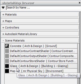

  5. On the Material Editor toolbar, click (Assign Material To Selection) to apply the Glass material to the glazing object.
    3ds Max applies the glazing material to the glazing. In the Scene Materials section of the Browser panel, now you can see a Glass entry, and the object name.

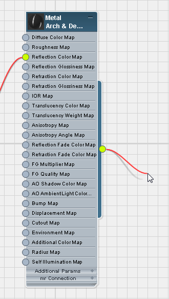

  8. This time drag from the Metal material node’s output socket, the round control at the right,
    Dragging from a material’s output socket
    ... and in the viewport, drop the wire on the metal shell object.
    ... and dropping onto an object
    Dragging and dropping is another way to assign a material.
