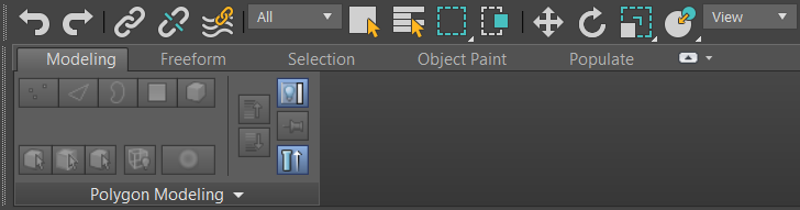

By default, a minimized version of the Graphite Modeling ribbon displays directly below the main toolbar.
Note: This lesson provides descriptions for workstations using a default ribbon toolbar display. The ribbon on your workstation might display differently if you customized it in a previous
3ds Max session.
- Click the
expand/minimize icon a few times until the full ribbon displays.
The Polygon Modeling tab displays with deactivated tools, since no polygon model exists in the scene.

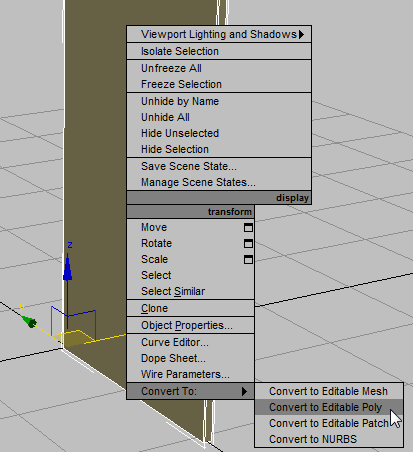

- Make sure the box is selected, right-click it, and from the Transform (lower-right) quadrant of the quad menu choose Convert To
Convert To Editable Poly.

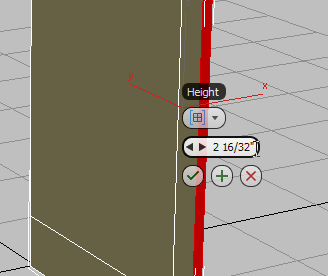

Click to select the upper face on the front of the panel.
- On the ribbon
Polygons panel,
Shift+click
(Extrude).
(When you
Shift+click one of these tools,
3ds Max displays the caddy controls for that tool.)
- On the second control of the Extrude caddy, Height, set the value to
2.5, then click
(OK).

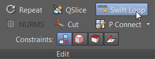

- On the ribbon
Edit panel, click
(Swift Loop).
Now, as you position your cursor near an edge, a green virtual loop displays. This helps you visualize the placement of the loop.
- In the viewport, click a horizontal polygon edge.
3ds Max creates a loop perpendicular to the edge you clicked. This method is a fast way to create and position a loop on a model.

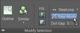

- On the ribbon
Modify Selection panel
drop-down portion, click
(Step Mode) to activate it.
When Step mode is active, selecting two sub-objects (in this case, polygons) also selects the polygons along the shortest path between the two sub-objects.
Click to select the inside top-left polygon at the back of the cabinet, then
Ctrl+click the inside bottom-left polygon.
Orbit, then
Ctrl+click to select the corresponding vertical polygons on the opposite side of the back of the cabinet.

- On the ribbon
Polygon Modeling panel, click
(Edge) to exit the Edge sub-object mode.

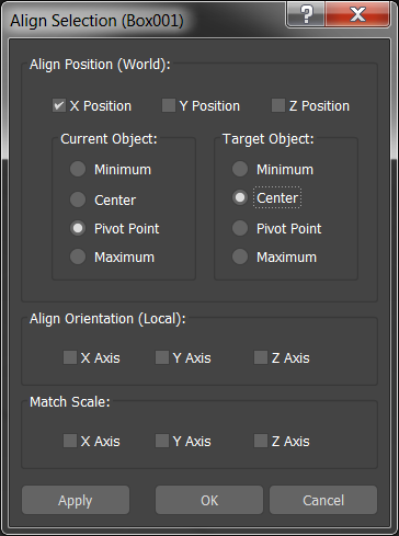

- In the Align Selection dialog
Align Position (World) group, make sure X Position is on and Y Position and Z Position are off. In the Current Object group, choose Pivot Point and in the Target Object group, choose Center, then click OK.
- Click Affect Pivot Only again to exit pivot-translation mode.
- With
Move active, in the status bar
transform fields, right-click the X spinner arrows to move the cabinet back to the world origin coordinates (0,0,0).

- On the main toolbar, click
(Align), then in the viewport, click the cabinet.
Align Position (World) group, turn on X Position, Y Position, and Z Position. In the Current Object and Target Object groups, choose Center, then click OK.
(Select And Move), then move the shelf on its Y axis until it is touching the backboard.

- On the ribbon
Polygon Modeling panel, click Modify Mode.
When active, Modify Mode makes the entire array of Graphite Modeling Tools available.

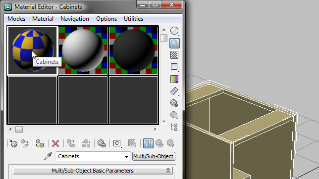

Assign material IDs:
Now you will assign material IDs to the cabinet polygons so they can receive different types of materials.
(Material Editor) to open the Compact Material Editor.
Note: There are two versions of the Material Editor: the Compact interface, and the Slate interface. The Slate version is more versatile when you are designing materials, while the Compact version is a bit more convenient when you just need to assign existing materials.
- Click the top-left sample slot to make it active. The material in this slot is named
Cabinets.
- In the Material Editor, click
(Assign Material To Selection).
Close the Compact Material Editor.
