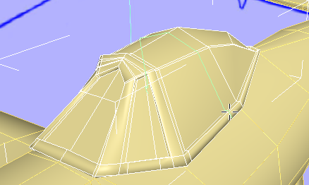

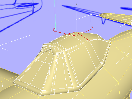

Refine the shape of the bubble:
- Activate the Perspective viewport and press F4 to turn Edged Faces back on.
- Turn on
(Swift Loop) again, and add a loop in front of the vertical loop that is already present, midway along the bubble portion of the canopy.
- Right-click to exit the Swift Loop tool.
- Go to the
(Edge) sub-object level.

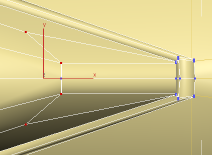

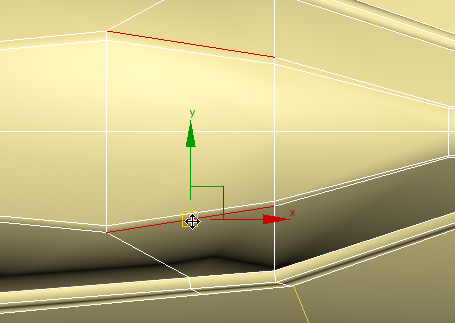

- In the Top viewport,
click and Ctrl+click to select the four edges at the top of the original bubble loop.
Perspective view
- On the ribbon
Edit panel, activate
(Constrain To Edge), and then in the Front viewport,
move the edges back, toward the tail of the airplane.

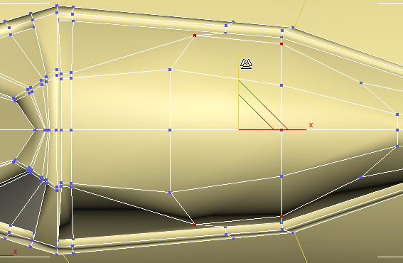

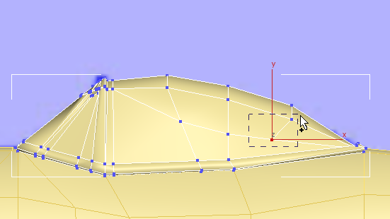

- With Move still active, in the Top viewport, click and Ctrl+click to select the two edges just above the sides of the middle of the bubble.
- In the Front viewport,
move these edges down to the middle of the side of the bubble.

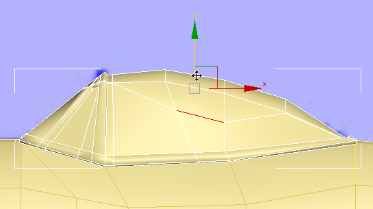

- Go to the
(Vertex) sub-object level.
- On the ribbon
(Constrain To Face).

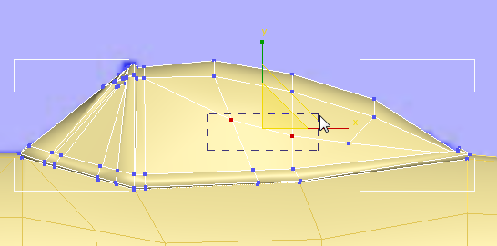

- With Move still active, in the Top viewport, click and Ctrl+click to select the two vertices where the side of the bubble meets the top, behind the vertical loops.
move these vertices down and forward so the bubble has a smoother contour.

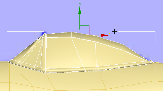

- On the ribbon
(Constrain To None).

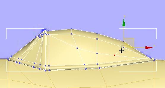

Expand the width of the bubble:
The last step in finishing the canopy, is to refine the bubble so the glass bulges a bit more, as shown in the blueprint images.

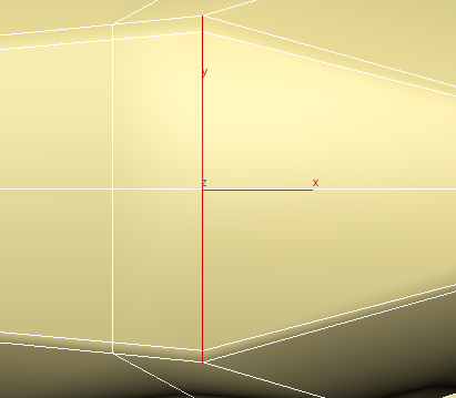

Ctrl+drag to select the vertices you just moved, as well as the vertices immediately above them on the same segment.
Look at the Top view to make sure you have selected four vertices: two on each side of the bubble.
- Activate
(Select And Uniform Scale), then from the Use Center flyout, choose
(Use Selection Center).

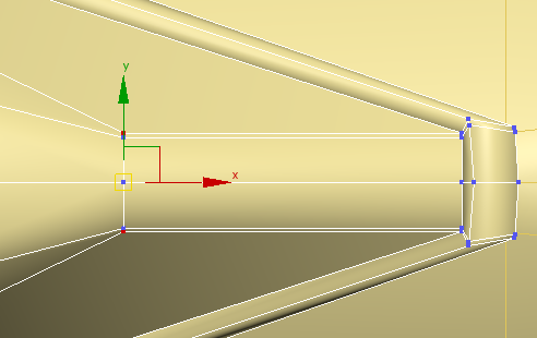

scale the vertices out along the Y axis to give the rear part of the bubble more of a bulge.

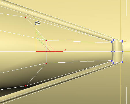

region-select the four vertices that are in front of the ones you just scaled, at the sides of the bubble along the contour.
scale these vertices out along the Y axis, as you did for the rear vertices.

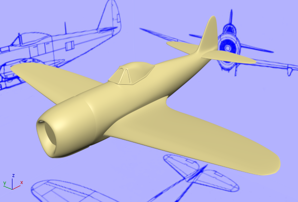

To see a finished version of the P-47 model, you can open
p47_completed_no_texture.max.
This version of the model includes some additional geometry adjustments that didn’t seem important enough to include in this tutorial.
You can also see a finished and textured version of the P-47 model by opening
p47_completed_textured.max.
The tutorial Controlling a Texture with Unwrap UVW demonstrates one way to texture this model.
