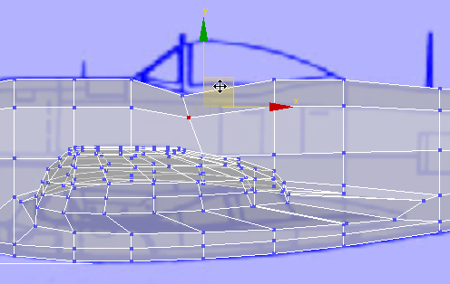

  1. On the ribbon Polygon Modeling panel, activate (Vertex).
  2. If X-Ray display is off, press Alt+X to turn it on again.

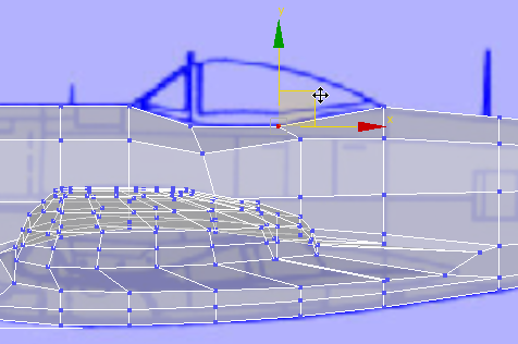

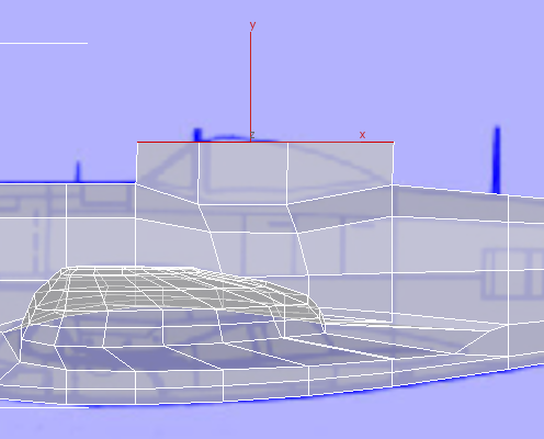

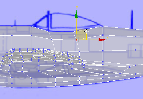

  3. In the Front viewport, region-select the top vertices just behind those at the front of the cockpit, and move them to match the cockpit outline in the blueprint image.
    Note: Now that the model is collapsed, when you region-select the top row, you are selecting three vertices: both sides and the middle of the fuselage.
  4. Region-select the vertices immediately below these along the lateral edge, and move them forward so the mesh is a bit more regular.

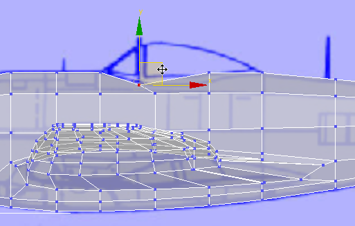

  5. Region-select the top vertices behind the ones you moved in step 2, and move them to match the blueprint outline as well.
  6. Region-select the vertices immediately below these along the lateral edge, and move them forward to adjust the mesh as you did for the more forward edge.

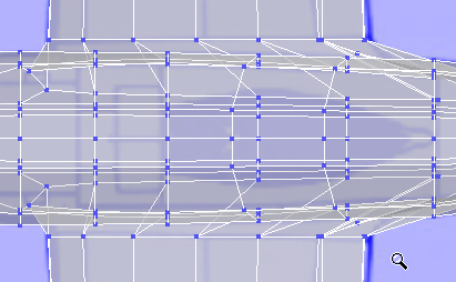

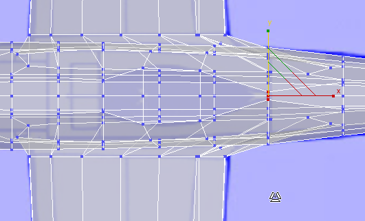

  7. In the Top viewport, pan and zoom in so you have a good view of the cockpit area.

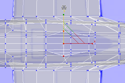

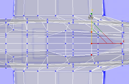

  8. In the Front viewport, region-select the row of vertices at the leading edge of the cockpit, and then in the Top viewport, scale them along the Y axis so they match the shape of the cockpit (the dark-blue area) in the blueprint image.
  9. Repeat the preceding step for the other three rows that define the area of the cockpit. Use the Front viewport to region-select the vertices, and then use the Top viewport to watch how you scale them.

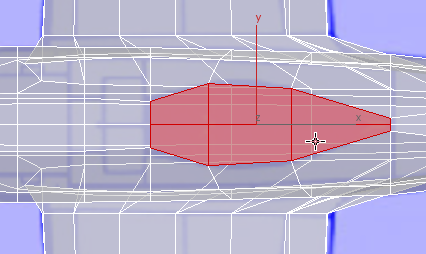

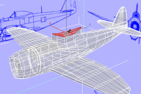

  3. In the Top viewport, click and Ctrl+click to select the polygons that make up the cockpit area.

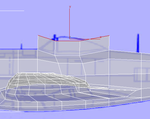

  4. On the ribbon Polygons panel, click (Extrude). In the Perspective viewport, extrude the polygons: Watch your work in the Front viewport, so you can make the extrusion about the height of the cockpit canopy in the blueprint image.
    Front view

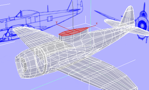

  5. On the ribbon Align panel, click (Align Y).
    Front view
    If you need to, move the polygons so that in the Front viewport, they are the same height as the canopy in the blueprint image.
