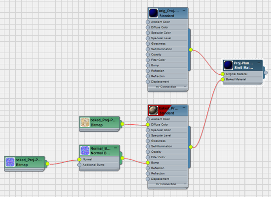

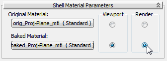

- Double-click the Proj-Plane_mtl [Proj-Plane] material node (the one at the right) to display the Shell material parameters.
As the rollout shows, the Shell material contains two types of material: the originally assigned plane material, which displays only when rendered, and the baked material obtained from the source object, which displays only in viewports.
- On the Slate Material Editor, click
(Zoom Extents) to see the whole material tree.
Tip: You might want to change the size of the Slate Material Editor window, and use some of the other navigation tools, to get a view you can read easily.
At the right is the top-level node, the Shell material you just inspected. Next to the left are the two sub-materials: The original, renderable material is above, and the baked, hardware material is below. The baked material has a Bitmap node and a Normal Bump map node. Finally, the Normal Bump node uses the NormalsMap bitmap you rendered in the previous lesson.

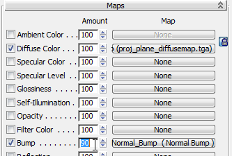

- In the Slate Material Editor, double-click the baked_Proj-Plane_mtl material node to display its parameters.
- On the Slate Material Editor toolbar, open the Show Map In Viewport flyout, and choose Show Realistic Material In Viewport.
Note: If you are using the Legacy Direct3D driver, the tooltip for this option reads "Show Hardware Material In Viewport.".
- On the Parameter Editor panel, open the Maps rollout, and increase the Bump amount to 90.
- Minimize the Slate Material Editor.
- In the Perspective viewport,
zoom in to get a closer view of the plane. The flat surface of the plane object takes on a greater, three-dimensional degree of detail.
- On the Shell Material Parameters rollout, set the Baked Material to be visible in the rendered output.

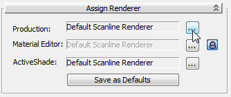

- Click
(Render Setup) to open the Render Setup dialog. On the Common tab, scroll down to the Assign Renderer rollout, then click
(Choose Renderer) for the Production renderer.
- In the Choose Renderer dialog, choose “NVIDIA mental ray,” then click OK.

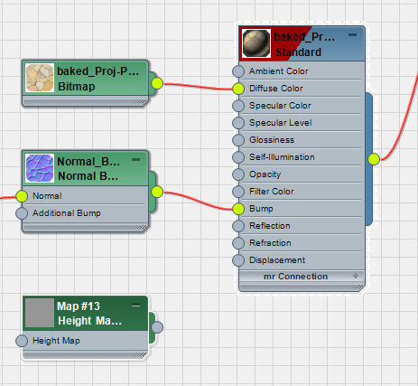

- From the Material/Map Browser panel at the left of the Slate Material Editor, locate Maps
mental ray
Height Map Displacement, and drag this map type to the Active View.

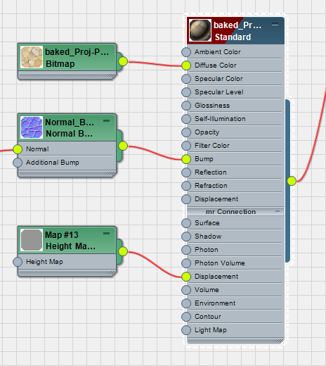

- In the active View,
zoom so you have a good view of both the baked_Proj-Plane_mtl / Standard material node and the new Height Map Displacement node.
- On the baked_Proj-Plane_mtl material node, click the plus-sign icon (+) to open the “mr Connection” group, and then wire the Height Map Displacement node to the “mr Connection: Displacement” component of the baked material.
- On the Material/Map Browser panel, locate Maps
Standard

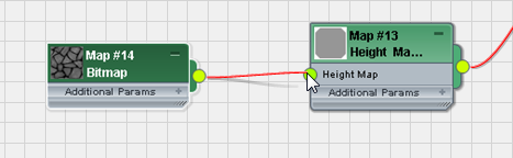

Bitmap, and drag this map type to the active View. 3ds Max opens a file dialog.
On the file dialog, choose
proj-planeheightmap.tga
Like the Diffuse and Normal Bump maps, this file should be located in
\sceneassets\images
, or in the folder you specified earlier on the Render To Texture
General Settings rollout.
- Wire the new Bitmap node to the Height Map component of the Height Map Displacement node.

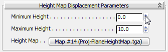

- Double-click the Height Map Displacement node to display its parameters, and on the Height Map Displacement rollout, set Minimum Height to 0.0.
Tip: An easy way to do this is to right-click the spinner arrows.

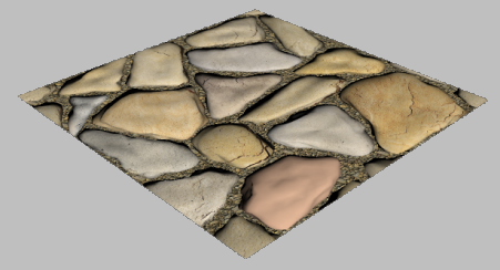

Render the Perspective viewport.
- Restore the view of the rendered frame you cloned earlier, and compare the renderings.
The geometry has been pushed up based on the displacement map generated by the mental ray engine and added to the rendering.
