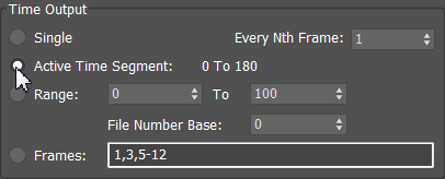

In the Time Output group, choose Active Time Segment. (If you left the setting at Single, just the currently displayed frame would render.)

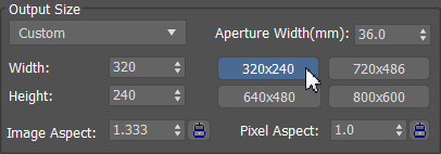

In the Output Size group, change the default (640 x 480) to 320 x 240.
This smaller size has only one-quarter the area of the default, making it much faster to render.

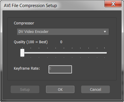

3ds Max opens a AVI File Compression Setup dialog.
Click OK to choose the default settings.
Note: You can use the Compressor drop-down list to choose a particular video compressor, or
codec. The available choices depend on your system setup. Many codecs let you use the Quality slider to adjust the quality of the output (primarily the output resolution). For the default DV Video Encoder, this control is not available.
