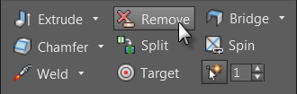

- On the Edges panel, click
(Remove).

- Activate
(Edge) again, then on the Edges panel,
Ctrl+click
(Remove).
Ctrl+Remove removes the vertices as well as the edges.
Both edges and vertices removed

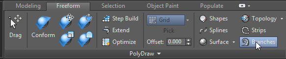

- On the ribbon, click the Freeform tab, and on the PolyDraw panel, click
(Branches).
Shift+drag the selected polygon outward, away from the helmet, then release the mouse.
