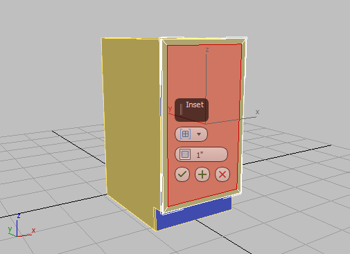

- In the viewport,
select the front face of the door and on the ribbon
Polygons panel,
Shift+click
(Inset).
3ds Max displays the caddy controls for the Inset tool.

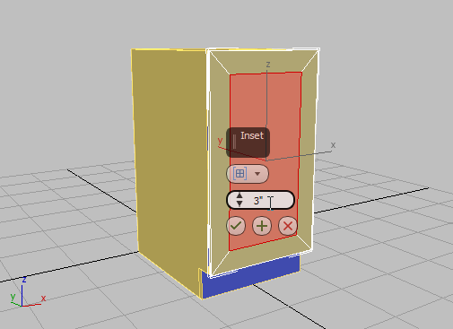

- On the second control of the Inset caddy, Amount, set the value to
3.0, and then click
(OK).
This creates a three-inch inset for the selected polygon.

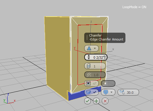

- On the ribbon
Modify Selection panel, activate
(Loop Mode).
Click one of the edges that surround the inset panel.
3ds Max selects a loop around the perimeter of the panel inset.

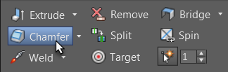

- On the ribbon
Edges panel,
Shift+click
(Chamfer).
- On the first control of the caddy for the Chamfer tool, Edge Chamfer Amount, change the value to
0 2/32, and then click
(OK).
The inside edge of the raised panel now has a slight bevel to it.
