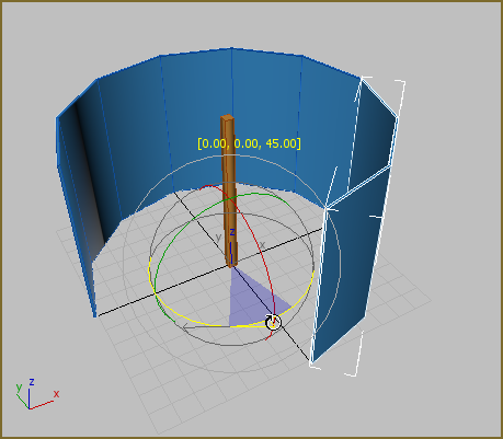

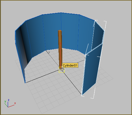

Rotate the right enclosure:
Select the
right enclosure panels object.
- On the main toolbar, click to activate
(Select And Rotate), and then move your mouse over the Transform gizmo tripod in the viewport. When the Z axis (the blue horizontal circle) is highlighted, click and drag to rotate the
right enclosure panels object 45 degrees about the Z axis until it touches the
left enclosure panels object, as shown below.
As you rotate, you can see the rotation amount in yellow text in the viewport, just over the transform gizmo. To get the desired result, it should read (0.00, 0.00, 45.00).
Rotate the right enclosure.
This rotation is temporary, for the purpose of modeling only.

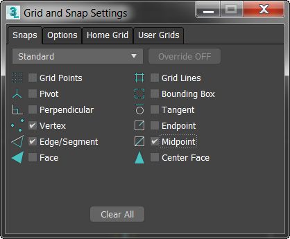

- Right-click any of the Snap buttons on the main toolbar, or from the menu bar choose Tools
Grids And Snaps
Grid And Snap Settings.
3ds Max opens the Grids And Snap Settings dialog.
- On the Snaps panel, click Clear All, then turn on Vertex, Edge/Segment, and Midpoint.
Close the dialog.
Note: Even though you've changed the snap settings, you still need to turn on snapping.

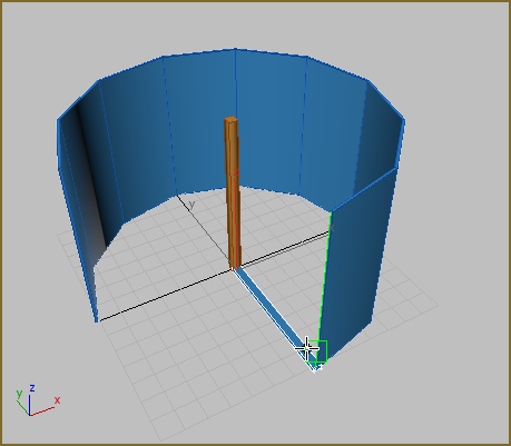

To create a door, you use the mouse in three distinct steps:
- Drag the mouse and then release it. This sets two points that define the width of the door, as well as its initial angle.
- Move the mouse to adjust the depth of the door frame, and then click to set the depth. (In this lesson, you click without moving the mouse, to accept the default of 0' 0". The Depth setting is the depth of the door frame rather than the door itself, which has a fixed depth.)
- Move the mouse again to adjust the height of the door, and then click to set the height.
- In the Perspective viewport, move your cursor over the cylinder in the center.
You can see the snap icon that follows the edges of the cylinder as you move.
- Position your cursor so you are snapping to the bottom-right edge of the cylinder.
- Drag to the right, away from the cylinder,
keeping the mouse button depressed. Snap to the front of the right enclosure object. Release the mouse button to set the width of the door.
Snap to the right enclosure.

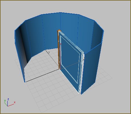

- Press
S to turn snaps off.
- Without moving the mouse, click once to set the depth of the door frame (the default value: 0' 0"), and then move the mouse upward to adjust the height of the door. Click to set the height. Don't be precise about the height: You'll correct this in the next procedure .
Set the Height last.
Adjust the door parameters:
Immediately after clicking to set the height, make the following parameter adjustments, watching the effects in the viewport. You can adjust these parameters at any time in the future using the Modify panel.
- In the Frame group, turn off Create Frame.
The frame disappears from the door.
- On the Leaf Parameters rollout, increase the Stiles/Top Rail value to
0' 5.0”.
- Set the Bottom Rail parameter to
1' 6.0".
- Going back up to the main door parameters, change the Width of the door to
5' 5.0" so it fits inside the enclosure. Change the Height of the door to
7' 0.0". You may want to adjust the Depth as well, but make sure the door is narrower than the side of the cylinder.

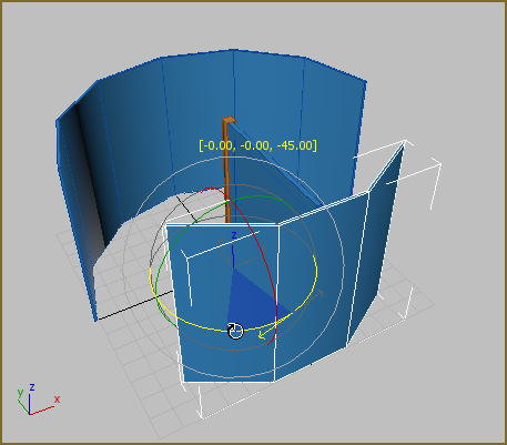

Rotate the enclosure:
Select the
right enclosure panels object: the one you rotated earlier in this lesson.
Rotate the sliced tube back into place; that is, –45 degrees on the Z axis.
Tip: If you prefer, you can enter the rotation in the coordinate display on the status bar.
Note: If the pivot door sticks through the enclosure after you rotate it, select the pivot door and on the
Modify panel, reduce its width so it fits within the space properly.

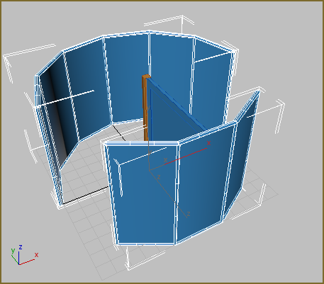

Add struts to the enclosure:
You'll use a Lattice modifier to add struts to the enclosure. The glass panels will be held up by stout uprights that you will create next.
- On the Layers toolbar, choose the
Enclosure layer from the drop-down list.
- On the Layers toolbar, click
(Select Objects In Current Layer).
This selects both enclosure objects and deselects any other objects.
- On the menu bar, choose Edit
Clone.
- Choose Object group
Copy, and click OK.
3ds Max makes copies of the two enclosure objects and selects the copies.
- On the menu bar, choose Modifiers
Parametric Deformers
Lattice.
3ds Max applies the Lattice modifier to the enclosures.
- In the Parameters rollout
Geometry group, choose Struts Only From Edges.
The right and left enclosure panels now are held up by struts.
