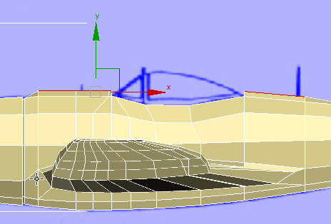

Improve the curvature of the top front portion of the fuselage:

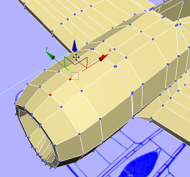

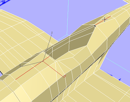

  1. Click and Ctrl+click to select the three ridgeline edges in front of the cockpit, and the ridgeline edge immediately behind it.
    Tip: Use region selection for the small edge where you reinforced the front of the cockpit. If you select an edge by mistake, use Alt+click to deselect it.

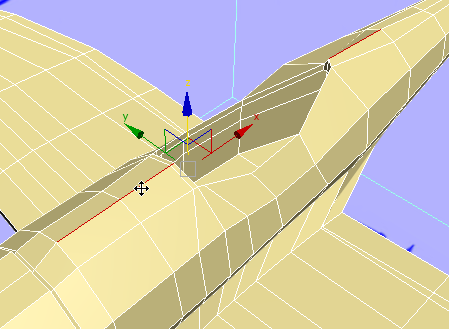

  2. Move these edges up vertically a bit, to make the fuselage more rounded. Use View coordinates for this transform.
    Front view

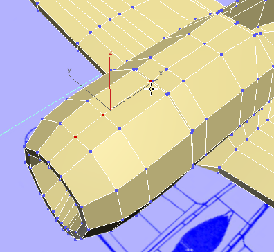

  1. Switch to the (Vertex) sub-object level.

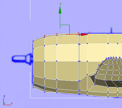

  2. Click and Ctrl+click to select the three vertices along the top of the engine cowl.
  3. Move these vertices up a bit, as well.
    Front view

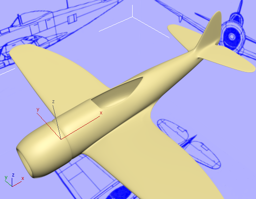

    Now the fuselage is convincingly rounded.
  7. Turn off (NURMS).
