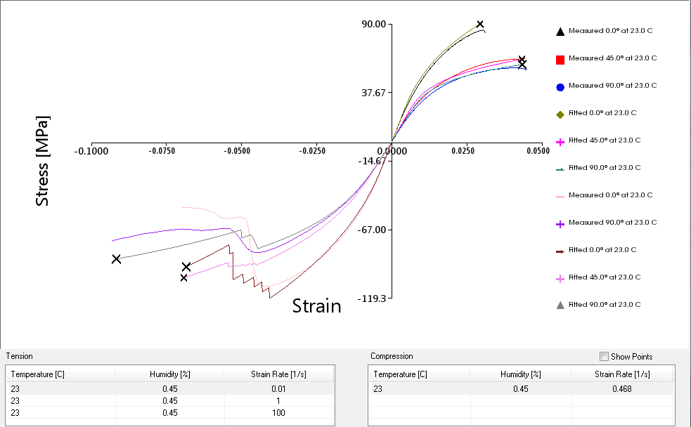

Plot Data
Use the Plot Data button to visualize the measured data and the idealized data produced by Advanced Material Exchange. These visualizations are useful to compare the idealized representation of the material with the measured data. If you have both tensile and compressive data, both sets of data are shown on the plot.
If you have data characterized at multiple environments (temperature, humidity, or strain rate), you must select the environment you wish to use for the analysis (one tensile and one compressive). At this time, Advanced Material Exchange does not interpolate between environments. If you have multiple environments, the plot will update as you switch from one environment to the next.

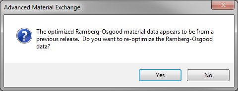

Import Models with Old Ramberg-Osgood Data
When importing a Moldflow model that contains Ramberg-Osgood data from a previous release, you can choose to re-optimize the material using the previously saved stress-strain data. After importing the Moldflow and structural models you will see a message asking if you would like to re-optimize the material. Selecting 'Yes' will immediately re-optimize the material. Selecting 'No' will allow you to proceed using the existing Ramberg-Osgood data.
