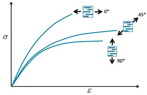

Tension
With the current model, good fits can be obtained by using three different tensile tests to failure. The image below shows such a collection of tensile tests and includes data from tensile loading at three different directions relative to the average fiber direction of a mostly-aligned material. The tensile tests include 0°, 45°, and 90° specimens. In each case, the specimen is loaded until final rupture occurs.
The model coefficients that must be determined include four elastic coefficients and four plastic coefficients. The elastic coefficients include the elastic and shear moduli of the matrix constituent and the elastic and shear moduli of the fiber constituent. The four plastic coefficients include σ0+, n+, α+, and β+.
The model fitting process is performed in two steps.
  1. The four elastic coefficients are determined by requiring the model to accurately represent the initial elastic responses of the 0°, 90°, and 45° tensile test specimens (as provided by the first few data points from each of the three tensile tests).
  2. The four plastic coefficients are fit to allow the model to accurately represent the full response history of all three tensile tests.

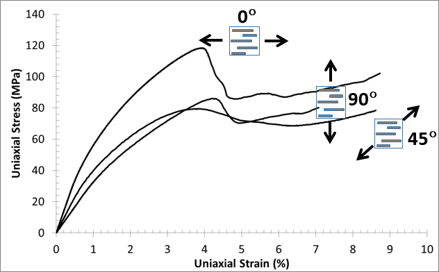

Compression
In compression, good fits can be obtained using three different compressive tests to failure, or at least well beyond the load drop. The image below shows such a collection of compressive tests and includes data from compressive loading at three different directions relative to the average fiber direction of a mostly-aligned material. The compressive tests include 0°, 45°, and 90° specimens.
The model coefficients that must be determined include four elastic coefficients and four plastic coefficients. The elastic coefficients include the elastic and shear moduli of the matrix constituent and the elastic and shear moduli of the fiber constituent. The four plastic coefficients include σ0-, n-, α-, and β-.
  1. The four elastic coefficients are determined by requiring the model to accurately represent the initial elastic responses of the 0°, 90°, and 45° compressive test specimens (as provided by the first few data points from each of the three tensile tests).
  2. The four plastic coefficients are fit to allow the model to accurately represent the response history of all three compressive tests up to the point of the load drop. After the load drop is reached, the plasticity response continues to evolve.
