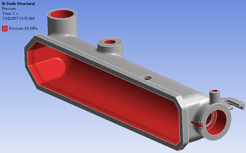

Define the Load
We will load the tank by applying an internal pressure of 0.50 MPa.
Click
Loads
Pressure
and select the interior surfaces of the tank as shown below.
Click
Apply
to confirm the geometry selection and enter a magnitude of
0.50 MPa
