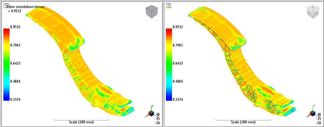

Now we are ready to map results to the structural model.
  1. Switch to the Home tab and click (Home > Mapping > Map Results).
  2. Rotate the model as necessary to examine the mapped results.

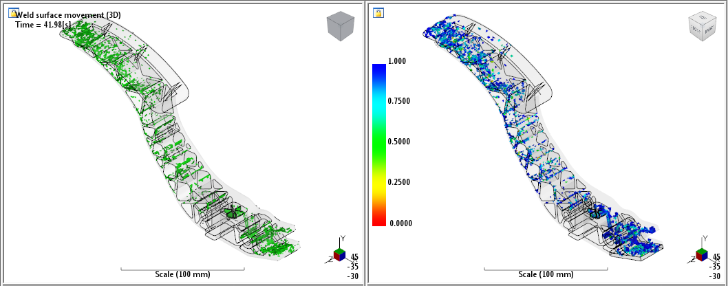

  3. Switch to the Weld Surfaces view (Home > View Results > Weld Surfaces) to see how the weld surfaces were mapped to the structural model.
