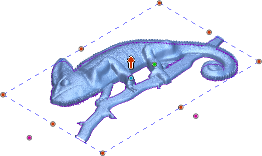

Interactively editing the Z height of relief clipart
When you are using the Transform tool and your selection includes relief clipart, a control arrow pointing in the Z direction is displayed. Click and drag this arrow to resize all selected relief clipart in the Z direction. This tool enables you to interactively blend heights with another relief or relief clipart.
