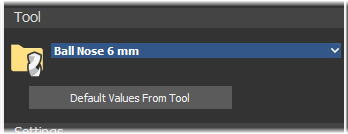

Texture Toolpaths panel — Tool
In the Tool area, click the Click to Select control bar to select the tool you want to use using the Tool Database dialog. When you select the tool, click the control bar showing the name of the tool to display its parameters. To change the selected tool, click Select. To deselect the selected tool without choosing a replacement, click Deselect.
After you have selected a tool, click Default Values From Tool if you want to use the default values in the Pattern, Depth Profile, and Drive Vector areas.
