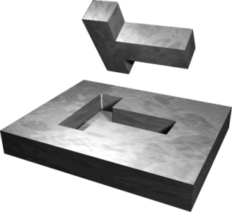

Use the Inlay Wizard to produce different kinds of inlay and insert toolpaths. You can use these toolpaths to machine interlocking male and female parts. ArtCAM enables these interlocking parts to fit perfectly by adjusting the shape of the corners according to the tool that is used to machine them.
Click the Create Inlay Toolpath
button on the Toolpaths panel to display the Inlay Wizard panel, then select the Inlay Type you want to create:
- Pocket — Select to display the Female Pocket panel and create a hole in the material that does not go right through the block. You can then create a male straight insert to fit into the pocket.
- Hole — Select to display the Female Inlay panel and create a hole through the block of material. You can then create a male straight insert to fit into the hole.
- Stepped Pocket — Select to display the Female Stepped Pocket panel and create a stepped hole in the material that does not go right through the block. You can then create a male stepped insert to fit into the stepped pocket.
- Stepped Hole — Select to display the Female Stepped Inlay panel and create a stepped hole through the block of material. You can then create a male stepped insert to fit into the stepped hole.
- Straight — Select to display the Male Insert panel and create a male straight insert from the block of material. You can then create a female hole or pocket into which to fit the male straight insert.
- Stepped — Select to display the Male Stepped Insert panel and create a male stepped insert from the block of material. You can then create a female stepped hole or stepped pocket into which to fit the male stepped insert.
