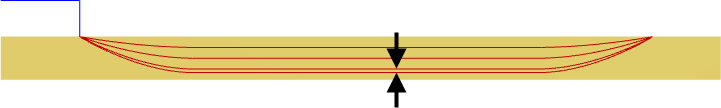

- Final pass thickness — Select to specify a thickness for the final pass of the toolpath.
When selected, enter the final pass value. For example, you may want a general stepover of 3mm with a final pass of 1mm. This in effect gives you a couple of roughing passes followed by a finishing pass.
