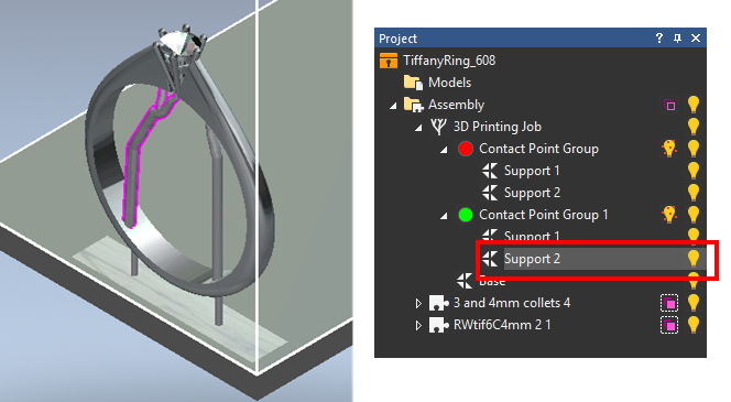

Deleting contact supports
After you have generated the supports for your assembly, you can delete any that you do not want before exporting the files to the printer.
To delete supports:
  1. Click the support you want to remove. The support is outlined in pink, and the corresponding mesh item is highlighted in the Project Tree.
  2. Right-click the selected support and select Delete from the context menu. Alternatively, right-click the highlighted mesh item in the Project Tree and select Delete from the context menu.
Note: The availability of this feature is license dependent.
