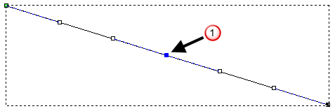

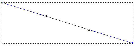

, right-click to display its context-menu.For example, a node
has been inserted into the Bézier curve span below. You can see that doing so has created a second Bézier curve span with two adjoining control points:
Before
After
