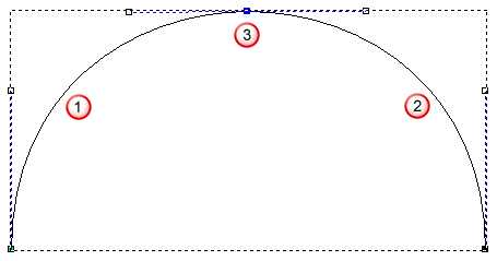

    For example, a vector with two spans is displayed as follows:
    Span 1
    Span 2
    Node
