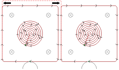

Distances are offsets
If you have selected the Distances are offsets option:
  1. In the X Offset box, enter the distance between each copy along the X-axis.
  2. In the Y Offset box, enter the distance between each copy along the Y-axis.
    Note: You can set the offset distance between each copy using a positive or negative value. To create a block of copies to the right of and above the selected toolpath, enter positive values in the offset boxes. To create a block of copies to the left of and below of the selected toolpath, enter negative values in the offset boxes.
  3. In the Number of Rows and Number of Columns boxes, enter the number of rows and columns you want to create.
