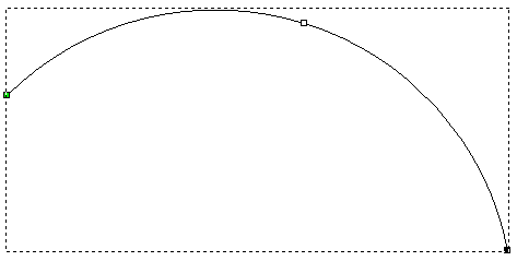

Converting a span to an arc enables you to alter the appearance of a linear or Bézier curve span within a vector.
Converting a span to an arc places one control point in the middle of the span. This can be dragged to add or reduce the degree of curvature in the arc.

, right-click to display its context menu.For example, if you were to convert a Bézier span to an arc span you would see that one control point is positioned in the centre of the arc. You can drag the control point to create a curve.
Before
After
