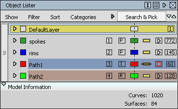

Layer Icons
The space to the right of the layer name can contain up to five icons. These icons provide additional information about the layer, and the ability to toggle between states. You control which ones are displayed through the choices at the bottom of the Filter menu. (Most of these choices are disabled when Show is set to By Object.) Roll over the icons to see a tool tip description.
The icons are, from left to right:
Layer Number Icon
Box that contains the layer number (for information purpose only).
Layer Pick State Icon
Box that contains the letter P (Picked), R (Reference), or I (Inactive). The color of the box also corresponds to that pick state. Clicking the icon cycles between the three states of the layer.
Objects on reference layers can be snapped to, but not picked.
Objects on inactive layers can neither be picked nor snapped to (like templated objects). However, objects on inactive layers can be shaded if you turn on Shade Inactive Layers in the Visualization section of Preferences > General Preferences.
Layer Symmetry Icon
Box that shows both the color and symmetry state of the layer. A vertical dashed line means that Symmetry is on. You can turn symmetry on or off by clicking the icon.
Note: This icon is the only one that appears when using Show > By Object mode.
Layer Bar Icon
Box that displays either a rectangular yellow icon () or a crossed-out rectangular yellow icon () depending on whether the layer appears in the Layer Bar. Clicking this icon toggles between the two.
Note: If Show > By Layer (Layer Bar) is selected, the layer disappears from the Object Lister when you set this icon to . Select Show > By Layer (All) to make it reappear.
Layer Playback Icon
Box that displays either a play icon () or a stop play icon () depending on whether animation on this layer plays when you hit Play on the Animation Time Slider Bar. Clicking this icon toggles between the two.

Search and Pick
The Search & Pick field at the top right of the Object Lister window helps you dynamically sort and arrange objects. For example, if you have a large model, and want to group all the curves, type “curve” in this field, then press (Windows) or (Mac). All objects whose names start with “curve” (case insensitive) are picked in the Object Lister, as well as the modeling window. You can scroll up and down in the Object Lister to check the picked objects and can cross-check in the modeling window.
Hold the (Windows) or (Mac) key and click to unpick any curve object that is not required for the group. Then create a new group node or put the curve objects in an existing group node.
If a collapsed group node has a picked "curve" object, the group node expands, to make it easier to find the picked geometry.
You can also use the “*” character as a wildcard. For example, *shell* will find all objects whose names contain the string “shell”, and *30 will find all objects whose names end with “30”.

Highlight colors
Objects and layers are highlighted in different colors to indicate the following:
  • White - Selected object
  • Light green - Object with construction history
  • Light blue - Selected layer
  • Yellow - Construction layer
  • Brown - Reference layer (objects are not pickable but are snappable)
  • Dark blue - Inactive layer (objects are templated)

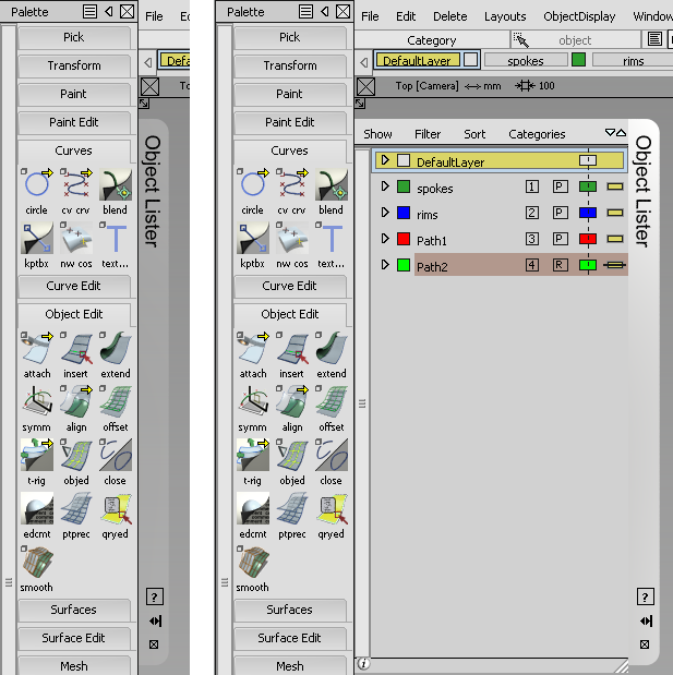

Option box
Embedded
Turn on this option to display the Object Lister as a collapsible window which appears as a narrow vertical tab against the left-hand-side of the main Alias window when not in use.
To open the Embedded Object Lister window, simply roll over its tab. The window stays open as long as the mouse cursor remains within its boundaries.
The window has two small icons on its tab. If you click the icon, the Object Lister window only opens or closes when you click its tab. Click the icon again to return the window to its original state. To close the window, click the close icon.
You can also resize the lister by dragging the striped triangle in its lower right corner.
