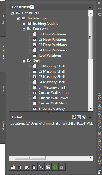

All drawings in the project are displayed and organized in the Project Navigator.
Project Navigator in AutoCAD Architecture
Depending on their function within the project, the drawings are classified according to different drawing categories:
Constructs
Constructs contain the geometry representing the building. They are drawing files containing one unique constructed part of the building. Each floor should be represented by at least one construct. If the building is large and complex, each floor can be created from multiple constructs, like one construct for the wall layout, one for the cubicles and furniture, and one for the framing elements.
