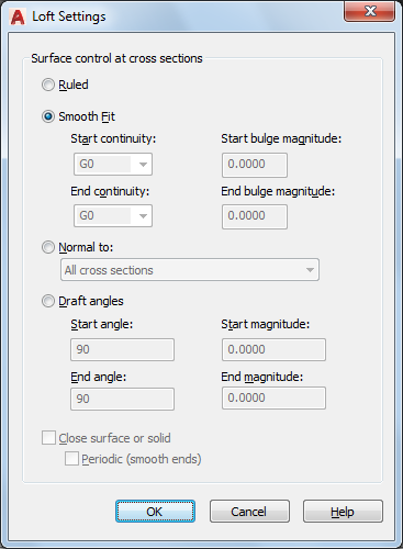

The following options are displayed.
Specifies that the solid or surface is ruled (straight) between the cross sections and has sharp edges at the cross sections. (LOFTNORMALS system variable)
Specifies that a smooth solid or surface is drawn between the cross sections and has sharp edges at the start and end cross sections. (LOFTNORMALS system variable)
Sets the tangency and curvature of the first cross section.
Sets the size of the curve of the first cross section.
Sets the tangency and curvature of the last cross section.
Sets the size of the curve of the last cross section.
Controls the surface normal of the solid or surface where it passes through the cross sections. (LOFTNORMALS system variable)
Specifies that the surface normal is normal to the start cross section.
Specifies that the surface normal is normal to the end cross section.
Specifies that the surface normal is normal to both the start and end cross sections.
Specifies that the surface normal is normal to all cross sections.

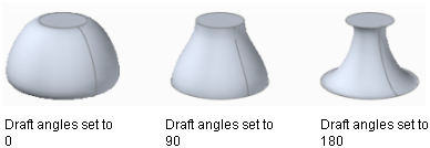

Controls the draft angle and magnitude of the first and last cross sections of the lofted solid or surface. The draft angle is the beginning direction of the surface. 0 is defined as outward from the plane of the curve. (LOFTNORMALS system variable)
The following illustration shows the affect of using a different draft angle for the first and last cross sections of a lofted solid. The first cross section is assigned a draft angle of 45 degrees, while the last cross section is assigned a draft angle of 135 degrees.
You can also use the draft angle handle to adjust the draft angle (triangular grip) and magnitude (circular grip).
Specifies the draft angle for the start cross section. (LOFTANG1 system variable)
Controls the relative distance of the surface from the start cross section in the direction of the draft angle before the surface starts to bend toward the next cross section. (LOFTMAG1 system variable)
Specifies the draft angle for the end cross section. (LOFTANG2 system variable)
Controls the relative distance of the surface from the end cross section in the direction of the draft angle before the surface starts to bend toward the previous cross section. (LOFTMAG2 system variable)

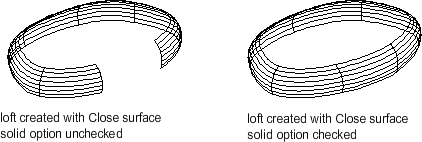

Closes and opens a surface or solid. When using this option, the cross sections should form a torus-shaped pattern so that the lofted surface or solid can form a closed tube. (LOFTPARAM system variable)
Creates a smooth, closed surface whose seam will not kink if it is reshaped. This option is only available if the loft is ruled or smooth fit and the Close Surface or solid option is selected.
