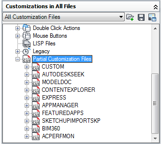

The Customizations In pane is used to navigate to the different user interface elements that are in the loaded customization files.
In this pane, you create and modify user interface elements such as ribbon tabs and panels, and the Quick Access toolbar. Along the top of the pane you will find tools that can be used to load partial customization files into the main customization file, save changes to the loaded customization files, and control how you view the loaded customization files.
The tree view is used to create and manage user interface elements. Once a user interface element is created, you add commands to it by dragging them from the Command List pane. You also can change the order in which commands appear on a user interface element such as a ribbon panel or toolbar, by dragging them up and down in the tree view.

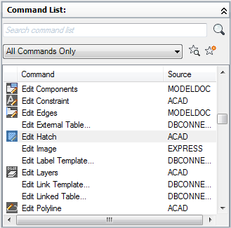

The Command List pane contains all of the commands available in the CUIx files that are currently loaded. You can select an existing command from the list to modify its properties or create a new command. If you create a new command, the command is added to the CUIx file that is displayed in the drop-down list near the top of the Customizations In <file name> pane.
At the top of the Command List pane is the Search Command List box, which allows you to filter the Command list based on an entered text string. The text string is matched with any part of a command name and the results are displayed in the Command list box.
The Categories drop-down list near the top of the Command List pane contains a listing of preset categories used to filter the commands displayed in the Command list box. The drop-down list contains some special categories. For example
The commands and controls that can be added to a user interface element are displayed at the bottom of the pane in the list box. Drag a command or control, and drop it onto a user interface element to display it as a button or control when the CUIx file is saved and loaded into the program.

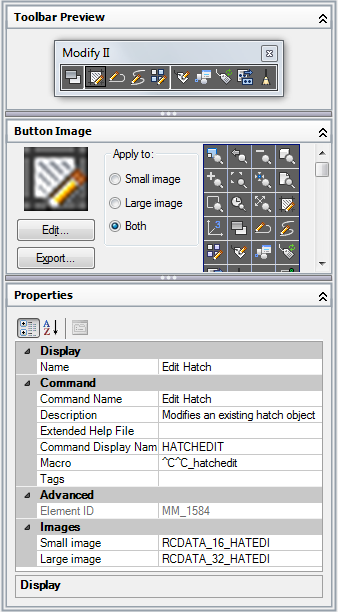

The Dynamic Display pane displays a preview of the user interface element selected in the Customizations In pane. It allows you to edit the image of a command selected in the Command List pane, and the properties specific to the item selected in the Customizations In or Command List pane.
Based on the item selected, one or more of the following panes will be displayed:
