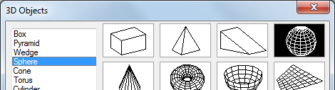

The purpose of an image tile menu is to provide an image that can be selected instead of text. You can create, edit, or add image tiles and image tile slides.
An image tile dialog box displays images in groups of 20, along with a scrolling list box on the left that displays the associated slide file names or related text. If an image tile dialog box contains more than 20 slides, the additional slides are added to a new page. Next and Previous buttons are activated so that you can browse the pages of images.
The following is an example of an image tile menu.
