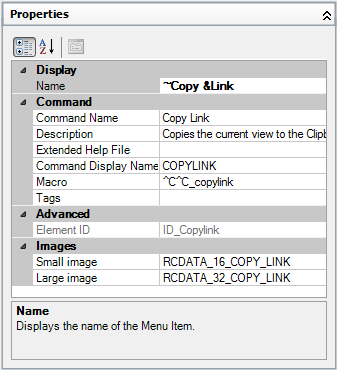

The following example disables the Copy Link menu item by adding a tilde (~) to the front of the value in the Name property.

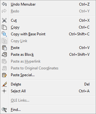

The following is the result of adding a tilde (~) to the Name property for the Copy Link menu item that appears on the Edit menu.
