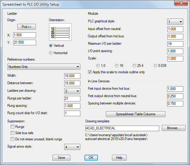

  3. Click Setup to define the drawing setup, including:
    • Number and orientation of ladders
    • Number and spacing of ladder rungs
    • PLC style and scale
    • In-line device placement and spacing
    • Drawing template

  6. Click OK until you return to the Spreadsheet to PLC I/O Utility Setup dialog box.
  7. Click Save to save the settings to a file for future use.
  8. Enter a file name for the .wdi settings file and click Save.
